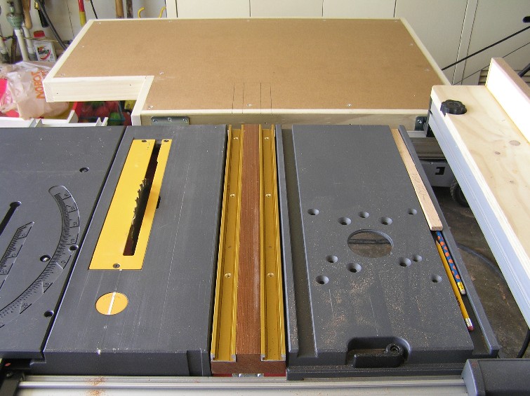

      I did a knockdown table out of a hollowcore door. It gets removed at the end of every session. http://www.bt3central.com/showthread.php?t=41179

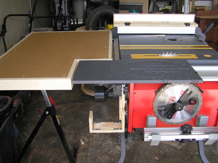

                Though not nearly as elegant as others, I like mine. It was easy and cheap. All I need to do is lift the front of the table, straighten the legs, and it's ready to go.
                http://www.bt3central.com/showthread...=outfeed+table

                  You never know what you don't know. If I had searched outfeed table, I would have found what I needed. You are almost as quick as the search function. Think I'll go with the hollow core as it is light and easily moved. Think I'll get the Rigid flip tops stands for infeed. Thanks to all.

                      Also, here's a smaller spin on the hollow-core door outfeed table.
