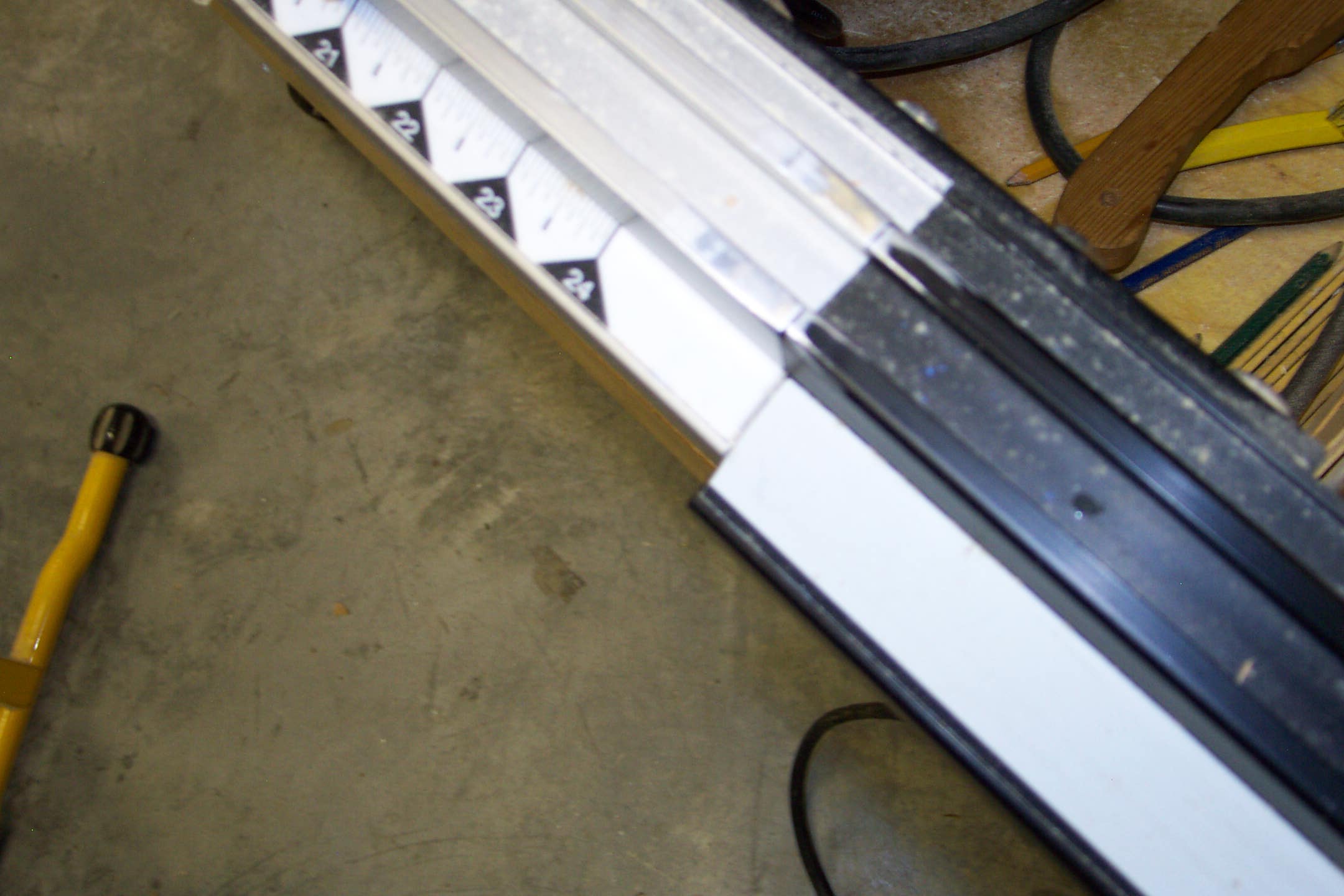

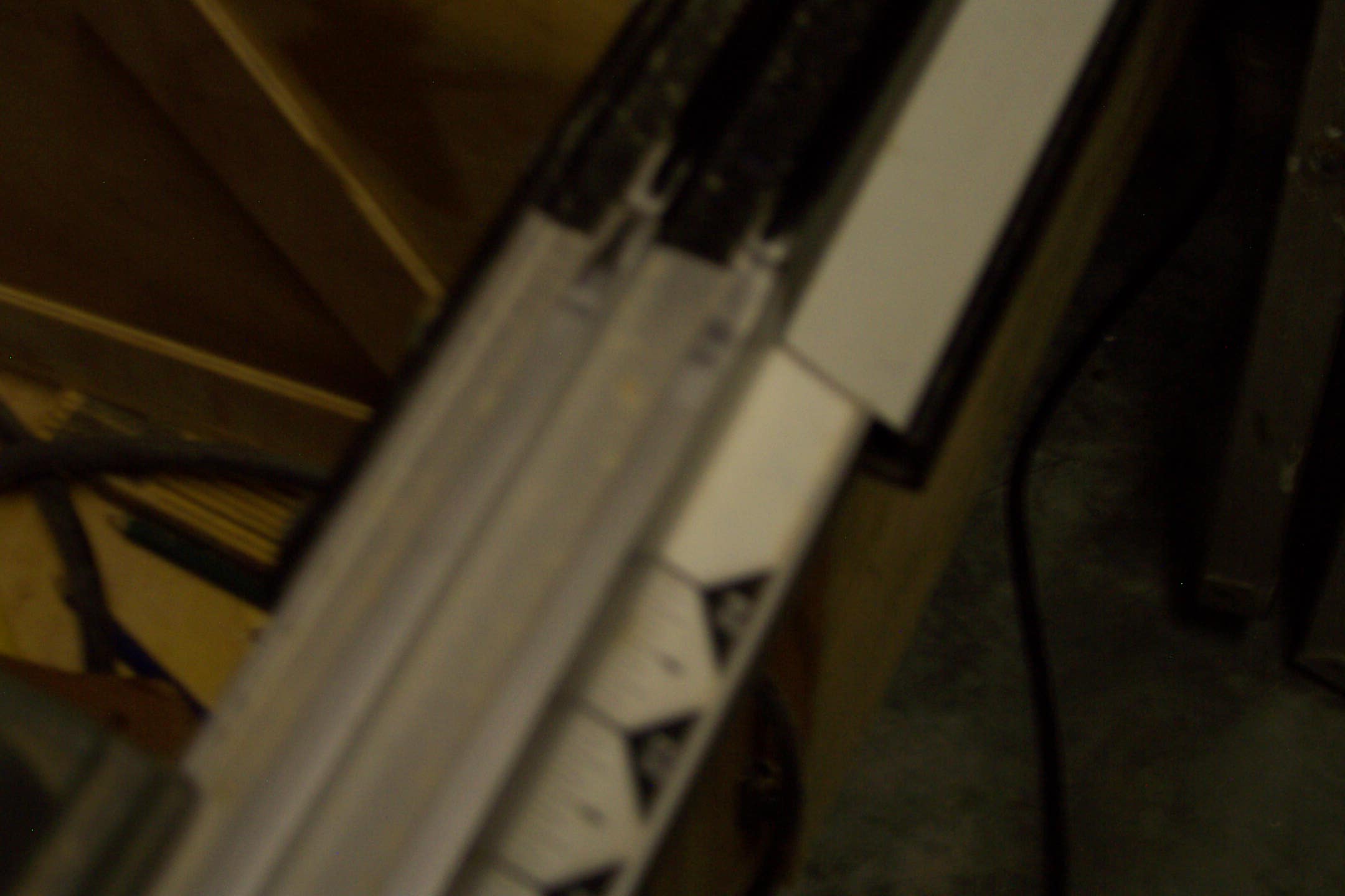

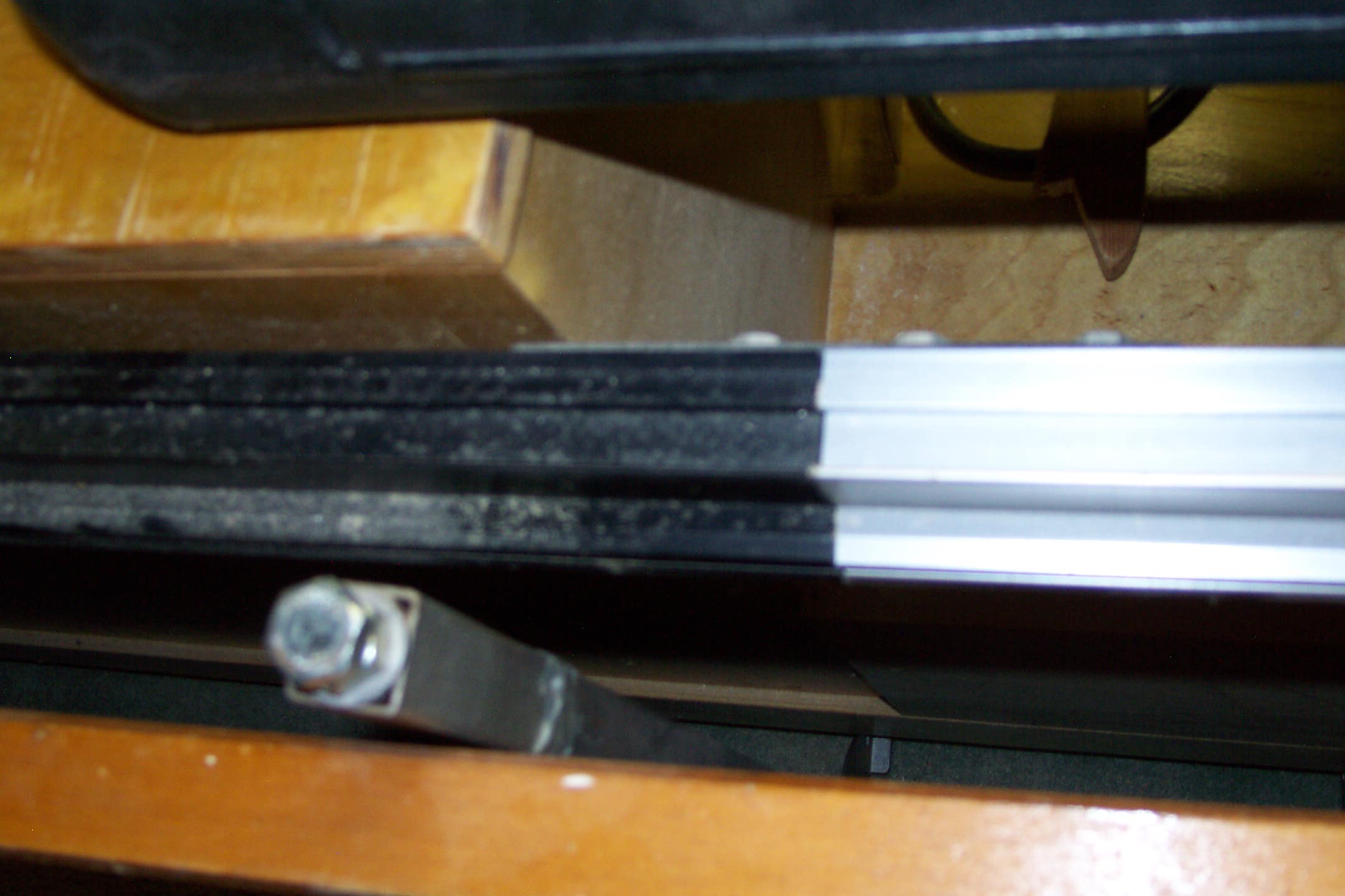

    I had the same concerns several years ago. And YES they will work. I have the 3000 model with the silver rails and made a cabinet for it. To extend the rails to the end, I used the black rails. On the front, the black rail is about 1/2 inch wider at the base. But it causes no problem.
    On the rear they match up perfectly for some reason. I just took some pics to show you, if I can get them loaded on here.
