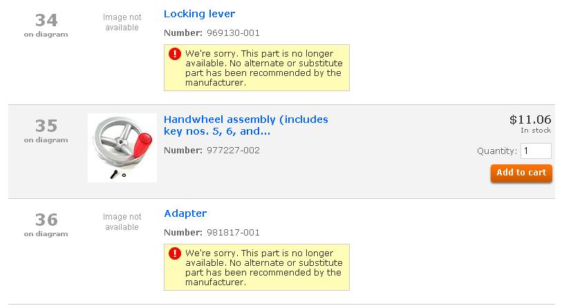

                          • 22052
                          its been said here that the adapter (#36) that makes the 22811 saw handwheel fit the BT3000/3100 shaft is no longer available. I just checked the Sears site and here is the info: "We're Sorry that part is no longer available. No alternate or substitute part has been recommended by the manufacturer."
                          (Note that the adapter is no longer available AND the locking lever is no longer available either!)
                          This adapter takes the wheel made for a 3/8" diameter shaft and makes it fit the 7/16" Square end of the BT3 Shaft.
                          Anybody know offhand the part numbers for the BT3100 and BT3000 handwheels?
