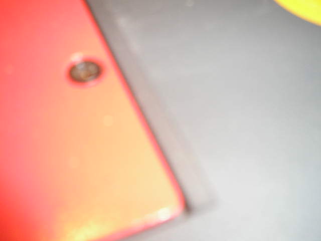

    HI, Now I'm curious about the rim of the throat area. On my saw (Craftsman) the ends of this area have a slight taper / bevel to them and the plate sits a little lower than the table , about 1/32". And the end of the plate doesn't extend to either end making it all flush / level. This dip also seems to be grabbing the tip of one of the pawls.
    I have noticed that the right pawl is a little wiggly (in and out) and that I don't have the spacer caps for them. Never did.
    I'm waiting the arrival of the Shark Guard kit and ZCTP - which is the same length I believe. But not sure on the thickness, if it'll be raised or not.
    Should I have any worries about this?
    pics are a little blurred.
    Glenn
    The ZCTPs that i use are flush with the main table top. The slope fore and aft are still visable with them installed. When you get yours you should have no worries about this. The slope on the back is almost required; you do not want anything that can stop the smooth exit of stock past the blade. A squared corner with a throat plate that is too low could potentially be very dangerous.
      Glenn,
      To keep the pawls from catching, try putting a thin piece of tape over them - it'll also help keep them from scratching up your workpieces. Instead of tape, I've cut the springs on mine, but some don't recommend that approach, and you still have to lift the pawls when lowering the blade to prevent catching. The pawls have lateral play, but I haven't had much trouble with that.
      The stock throat plate with the 21829 isn't flush - but you could use tape underneath to bring it up to flush. As Mark said, the ZCTPs seem to be made to sit flush, but they don't fill that bevel.
      I still use my OEM 21829 guard, but modified - but I'd say just tape the pawls until your Shark arrives.
        That's one thing I didn't like about the craftsman and ryobi plates, besides their ZCTPs that flex easily. Before I made some flush plates out of some maple flooring scraps. I shimmed my plates up with some tape.

                      i keep the plate area of the throat plate shimmed up with layers of tape to match the height of the main table. Even so, its advistable to put a bit of a draft on the leading edge of the throat plate so there's no way it can catch and maybe raie the back end of the throat plate a hair (maybe .005") above theable there so there's no way you can catch a piece of wood being ripped even it if's not perfectly flat.

                        I did have a little grab by the pawl finger after testing the blade lowering and elevation. Tomorrow I'll give it some tape as suggested and give it a whirl. Another thing, This plate only has 3 anchor holes, 2 back, 1 front and center.
