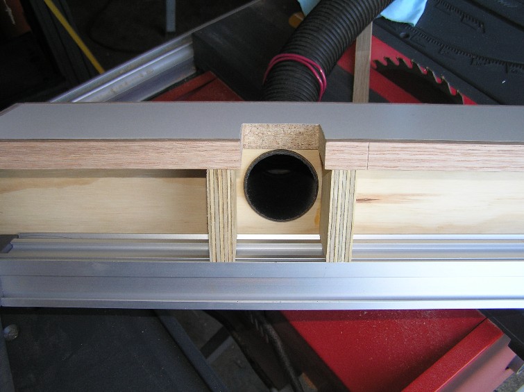

    Also, what do y'all think about the router fence peices that mount to the rip fence? Seems to me a single piece would be easiser and more accurate than the two separate pieces, which seem to be a little hard to get lined up just right. Or am I just doing something wrong?

    It sounds like you've got the router fence thingys just about figured out. They're better than nothing, but not by much. Honestly, I'd view the whole setup, including the router mounted in the accessory table, as temporary. You'll eventually want a proper router table insert and specialized fence. Having said that, I went for LONG time with the setup you have.

      I think the OEM router fence is a POS. I would say that it is the biggest design deficiency of the saw. I had big problems getting and keeping mine aligned. Making a simple router fence based on an old Wood magazine design was one of the better things I did for my router extension.

                    I didn't use the OEM router fence very long before changing over to a one-piece fence. MUCH easier to set. You can even attach it to the hardware from the OEM kit. I made mine to attach directly to the rip fence.
