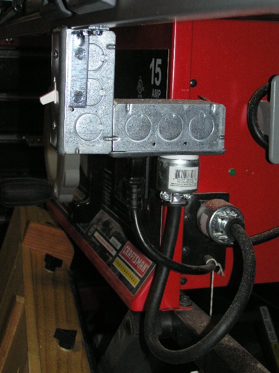

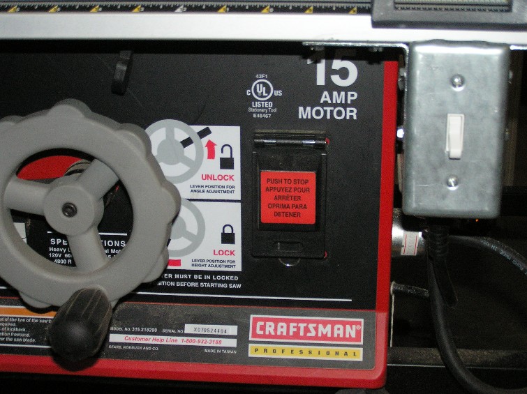

          After repairing my original switch twice, I replaced my switch on the saw with the new style switch, and added an "auxiliary switch box" between the saw switch and the power cord, using 15-amp household switch and outlet in connected single-gang boxes. I consider this a safety feature, since I must first turn on the saw switch which is unpowered until I turn on the ASB, which closes the power circuit. When I am done for the day, I turn off both switches, so I don't get any accidental power-ups from bumping the ASB. I believe this arrangement prevents any arcing in the saw switch, because the contacts are already closed when the ASB is used to supply power to the circuit.
          I mounted the ASB to the underside of the front rail, where it happens to be easier for me to reach. Not pretty, but functional for me. I'd be interested to hear how the OP resolves this problem.

              Loring, thanks for the clarification; I assumed arcing happened during both the closing and opening of the switch. I know the springs in my first switch were not up to the task, and I believe the replacement switch is better, but didn't want to chance another instance of being "stuck on". I think I have resolved this by not using the saw switch to turn off the saw, instead using my ASB, and only open the saw switch once there is no load on it.
