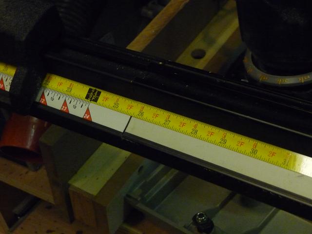

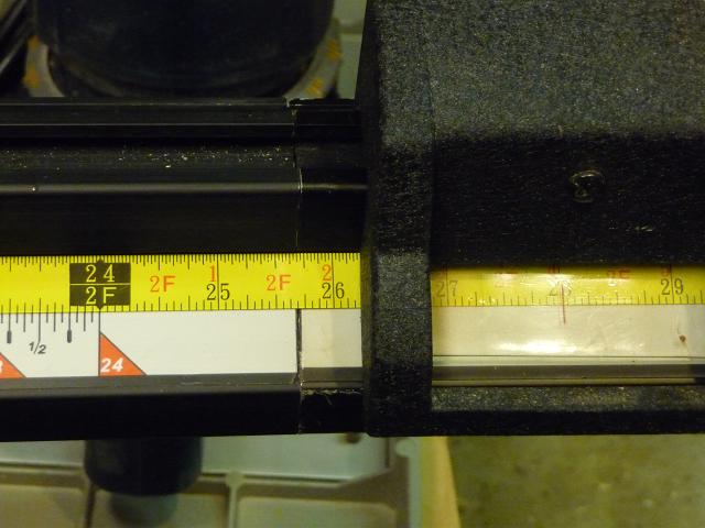

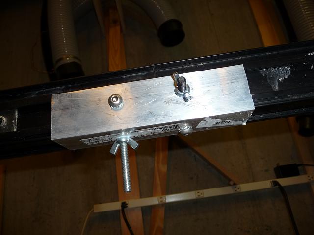

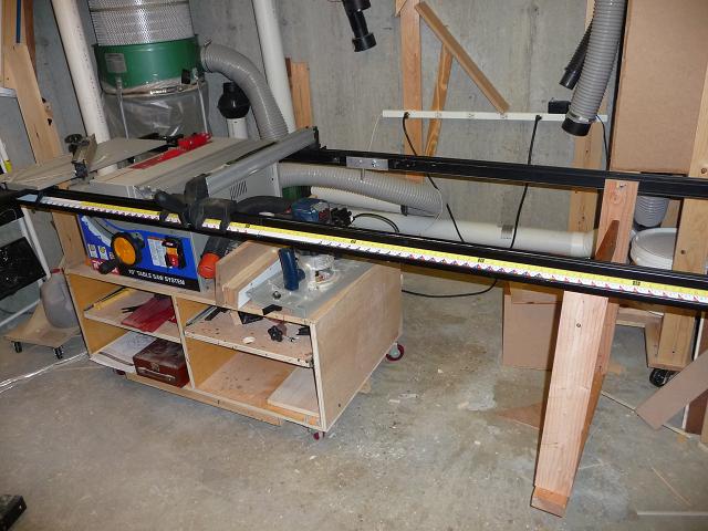

    I got a set of rails on ebay. Didn't come with connector plates but I used some T-nuts and aluminum angle and mounted them along with some legs. (The legs are attached to a plate with a wheel so I can move the whole saw). Picture 1 shows legs Picture 2 shows angle bracket.
    Then I mounted a sticky tape so I could measure cuts longer than 24 inches. Picture 3.

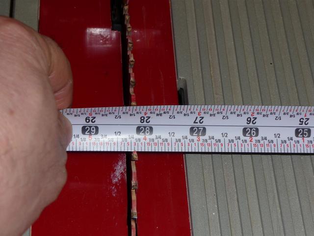

    The fence slides smoothly over the joint where the legs connect. However when I lock the fence the measurement from fence to saw blade is off - but only on the new legs. The old legs (up to 24 inches) measure exactly. Picture 4 shows the fence set at 28 inches and Picture 5 shows the fence to blade measurement at 28 and 1/8.
    Any thoughts on what I might do differently?

    Do you have a solid measure like a framing square that you could use instead of the tape? It may be something to do with the tape, but I am honestly taking a shot in the dark here... I don't have the extended rule on mine, and I double check my blade to fence distance out of paranoia all the time anyway...
      First, I'd check the new roll of sticky tape you put on for accuracy. If it checks out I'd make sure that the extension rails are parallel and in line with the other. I'd also measure the distance from the fence when clamped out on the extension to the blade at the front and back of the tables, using a straightedge up against the blade avoiding the teeth. I'm thinking that the extension rails are slightly cocked forward making the fence further away from the blade, maybe...
        • 22085
        so , i don't think its right at 24 inches, either.
        I'd make a chart of error vs. setting and see where it gets off.
        Is zero right against the fence or 1/8" off?
        is 12" right or 1/8" off?
        etc.
        I think maybe when you moved the saw you pulled the rail off so its all 1/8" off.

          Thanks. Taking some more measurements the fence isn't square to the blade. So I'll work on that and see if it fixes the other problem.

            Looking at it, it seems like it might be wise to have some sort of cross-piece between the front/rear rails near the joint and again near the far end. I could be wrong, but it seems like a fence that long would put a substantial amount of leverage on the joint and could easily torque it out of square a bit.
            Good luck!
              I don't have that saw, and never used one, so my comments are based on my experience with other saws in adding long rails, and maybe it would relate to your situation.
              With the length of those rails, there is likely some movement (front to back) due to not having a table top between them fixed to the saw, and keeping the rails parallel. That's where I would start. With rails that long they could be moved to be out of perpendicular to the fence, as they look in your pictures.
              Align the fence to be parallel to the blade. Raise the blade all the way up and pick one tooth and mark it with a sharpie. Once that is done, then set the fence manually at a fixed distance from the right side of that particular tooth. Make sure that tooth is close to the saw top. Use your measuring device (it can be a tape measure), and rotate the blade so that tooth is at the rear of the saw close to the table. Take another measurement. If they are the same measurements, rotate the saw blade so you mark another tooth. Lets say your first marks were at 12 and 6. Your next marks will be 3 and 9 (o'clock). Measure again. If they are the same as 12 and 6, the fence is parallel to the blade (and the blade isn't showing significant runout).
              Then install the sticky tape to the rails with the pointer at the measurement you used. If your cut indicator has an adjustable setting, use the center of the adjustment. HTH.

                Although I don't use my BT3100 any more, I still own it and used it for about four years before getting my cabinet saw. As you no doubt know, the BT saws are a completely different animal from conventional table saws and therefore require a completely different alignment methodology.
                I think Erik (pelligrini) is on to one excellent possibility. Compare the graduations on the sticky-back tape to your regular steel tape and see if they agree. I once bought a sticky-back tape that had better than 1/16" of error over a section just a few inches long ... up to that point it was accurate, then it drifted off, then it drifted back to where it was supposed to be.
                According to a VERY rough sketch I just drew up using CAD, if the front extension rail is cocked out of alignment by as little as one degree, you could easily get that 1/8" of difference you're seeing between 24" and 28". However, the far end of the added-on rail would then be maybe 3/4" out of parallel alignment, and you ought to be able to see that with the naked eye. Pull a string between the ends of the joined rails -- that will tell you whether there's a bend where the rails are connected. Do this first, as ensuring the combined rail sections are dead straight over their entire, combined length is the only way your blade-to-fence measurements will be meaningful at all points.
                It could be that you have a combination of errors ... partly the fence out of alignment, partly the rails are not straight, partly a discrepancy between one measuring tape and the other. Off a little here, off a little more there; it all adds up.
