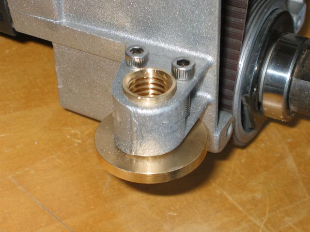

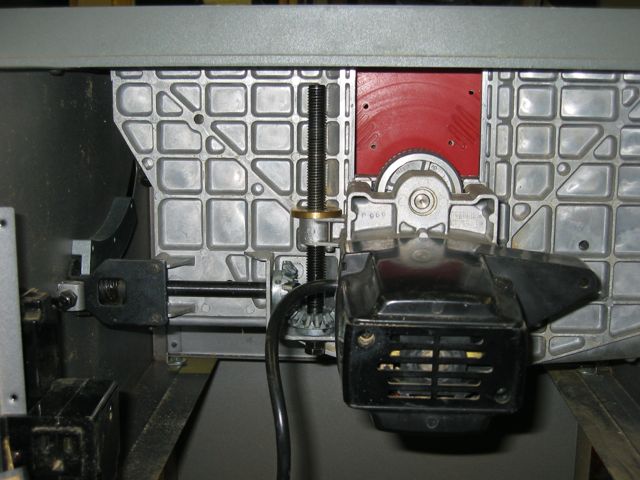

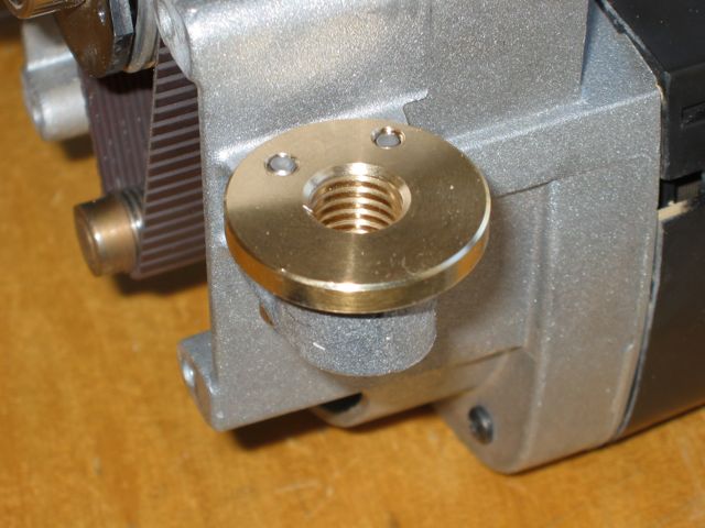

        I had this problem. After many years of cranking up and down, and not cleaning or lubricating it particularly well, the steel rod ate away the aluminum.
        I took my motor to a local machine shop that does tons of work in brass for submarines. He drilled out the aluminum to give him room for a brass bushing that he threaded. He tapped in a couple of screws to hold it all together. He charged me $65 which seemed reasonable. It is a nice fix, but it depends on your ability to find someone who can and will do this. I think I might have gotten lucky.
        I've attached a few photos. The large brass lip you see in the first photos did not clear the exterior of the blade assembly, I had to grind it down a bit.
