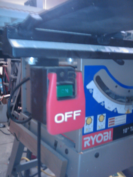

          Guess this isn't an isolated incident. I've replaced my switch a couple of years ago. Am in the process of changing it again for a "panic" stop type switch, and am moving it to where it should be, on the left side of the saw case. I have the power cord running into a standard receptacle that is switch controlled; then to the motor. This gives me an extra safety feature; I pull the plug to the motor whenever I am doing any blade changes, etc.

                    I got tired of taking my switch apart to clean it. Replaced it several years ago with a switch from Sears. Haven't had a problem since. Found the old post I made couple years back and it looks like they don't make that model anymore, but they do have a replacement.
                    http://www.searspartsdirect.com/part...art=&pop=flush
                    Here's my switch...
