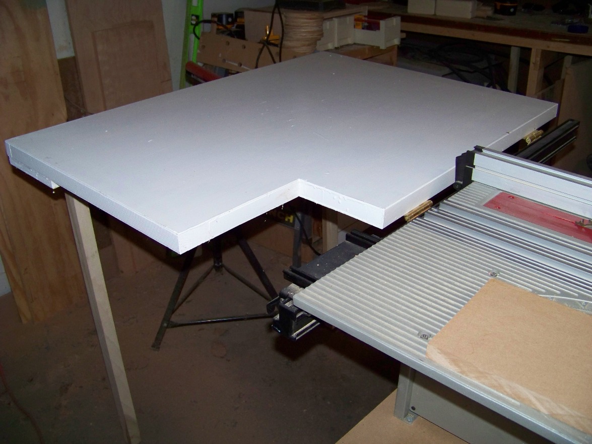

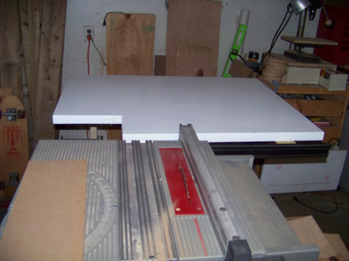

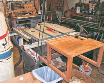

    Directly from the "Why Didn"t I Do This YEARS Ago Department" I present my outfeed table.
    A billion thanks go to (former?) member Gugie, who put up this site, from which I filched his idea:
    http://www.gugie.com/house/cheap_BT3...feed_table.htm

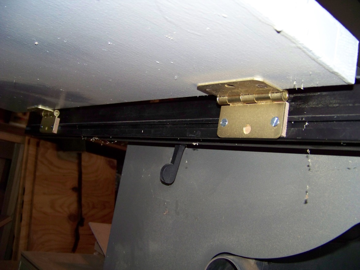

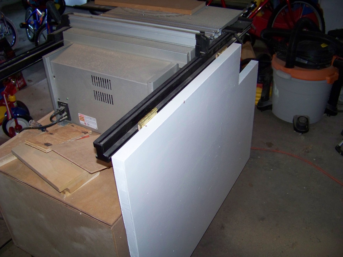

    It's basically just a cut down hollow core door, attached to hinges connected to the back rails via T-Nuts. Brilliantly simple.
    All told, I spent well under $10--the door was picked out of the trash . It was varnished or something, so I had to paint it. All I bought were the T-Nuts and hinges. Everything else was scrap.
    Sorry, the pictures are dark. I'm too lazy to replace a bulb tonight...

            Cool! You're really going to like it.

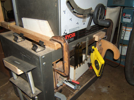

            I had the very same 'should have done this a long time ago' feeling when I got mine done. I also took a bunch of clues from Gugie.
            I ended up making mine a removable knockdown since my 21829 gets moved every session. http://www.bt3central.com/showthread.php?t=41179

              Joe,
              It looks like your table is higher than the saw table. Is it an optical illusion?
              Steve
              • JoeyGee
                • 1509
                • Sylvania, OH, USA.
                No, it's actually about 3/16" or so lower than the top of the table. My "shop" is very crowded at the moment with bikes, scooters, Cozy Coupes, etc. that don't get put away properly so I didn't have room to take any decent pictures.

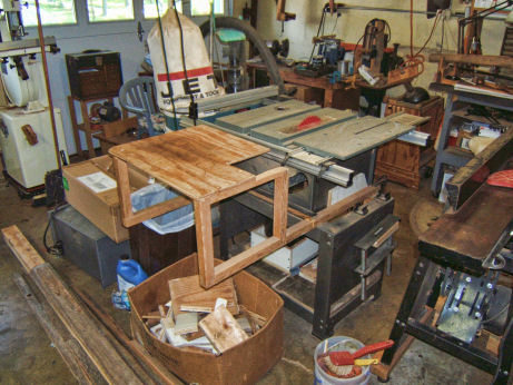

                          An Even Cheaper --and lower tech--Outfeed Table
                          The frame was made from ripped 2X4, and the table a scrap piece of 1/2 inch plywood. Crude, but it works. Wanna trade tables? I'll throw in a dozen 1" drywall screws to boot.
                          Jack
