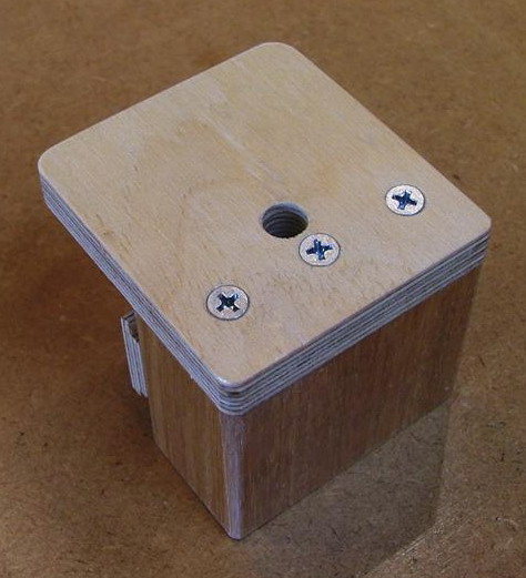

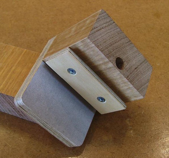

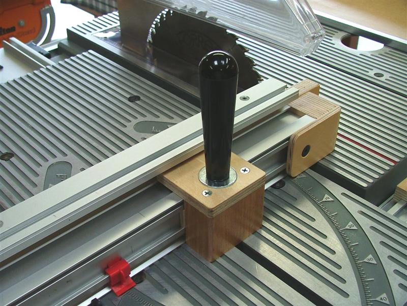

            • RodKirby
              • 3136
              • Mao Shan TSC-10RAS
              ...One famous former BT owner Rod Kirby made one and made his own knob. Likely some pics left around, if not I have the original in my possession!
              And here it is
ID:	784364Click image for larger version
              Downunder ... 1" = 25.4mm

                I think I'll try fashion one like Rod's - Don't quite know if I can replicate the tightening handle, should be able to get close enough.
