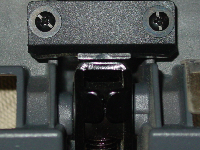

    The handle end of the fence "locks" by tension. The handle is on an eccentric inside a metal dohickey that pushes against a flexible plastic part (the one attached with 2 screws in the pic) and drives that plastic part into the fence to lock it in place. At the same time it pulls the other end of the fence to lock the rear end into place. The rear lock is supposed to pinch the lip on the rear rail. Seems as though you have a distance problem. Go back and make double sure you have the rails mounted correctly. They should be parallel all the way down their length within say a 64th to 128th of an inch. Also make sure there is no lubricant of any sort on the plastic piece or the fence face it contacts. Mine locks down quite securely and would take a good hit to move it.

      The BT3x rip fence is simply wonderful when it works right. It should take little effort to lock so perhaps you are trying to lower the locking handle too far. Reference the above pic. When you lower the handle an eccentric roller places pressure on "E" slightly drawing the front block towards the operator bringing the bosses "C" into firm contact with the back of the front rail while also pushing on a through rod that activates the rear clamper. Make sure that the nylon glides are adjusted so that at "D" the distance is just slightly more than the width of the rail, and parallel. When clamped they do not need to touch the rail insides. If yours do not fit into the rail something is wrong.

        That, sir, was the piece of the puzzle I was missing! My plastic plate is not at a 90 degree angle, but rather at a 45 degree angle. Therefore when I set the front of the fence on the rail, the end of the plate goes "inside" the rail and prevents the fence from locking.
        It also explains why the guides wouldn't comfortably fit inside the slots. They would when I removed the plate, but not when the plate was installed. Instead, the front of the fence would rest on the "back" of that plate and prevent the guides from going in the slot.
        In retrospect, as I look at the drawing, it does show it as a 90 degree piece, but since it was at a 45 when I took it out of the box, I "assumed" that the piece was correct. So either it's a manufacturing defect or a packaging defect.
        The second I saw your photo I knew where the problem was. I tried it and everything locks correctly and slides great when not locked.

          Thanks so much. This is an even clearer picture of what went wrong with mine.
            As a point of reference, the handle should meet resistance before it reaches 90 degrees. It should quickly gain resistance, with no need to move to beyond about 135 from top dead center.
