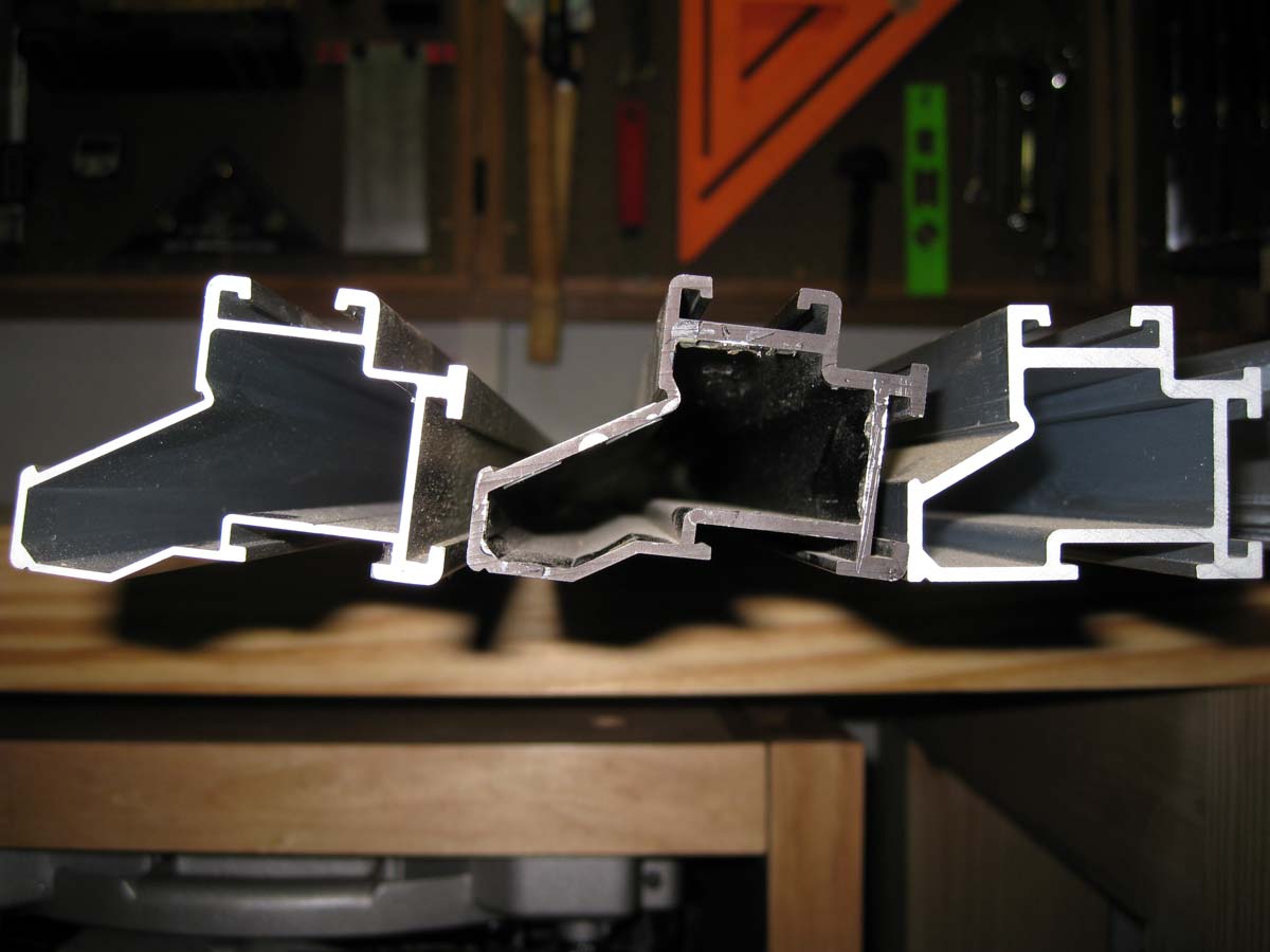

          The front extrusion is slightly different and that occurs only at the front edge where the number tape is. All the important parts line up. The BT3000 rails are 2-3/8" wide the black 3100 rails and the 21829 rails are 2-3/4" wide. Those two also hang down further by 1/4". I'll post a photo showing what is going on.
          The extrusion thickness of the 21829 rails is about 1/16 of an inch. The thickness of the BT rails are 1/8 and 3/32 in places.

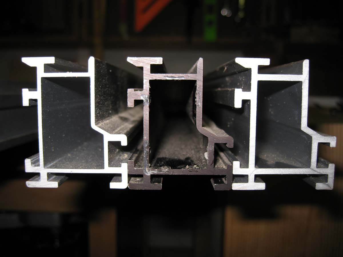

            Here's a few shots I took today:
            21829 rail on the left, black BT3100 middle, silver BT3000 on the right
            The other two photos show the difference in the front extrusions of the 21829 and the silver BT3000.

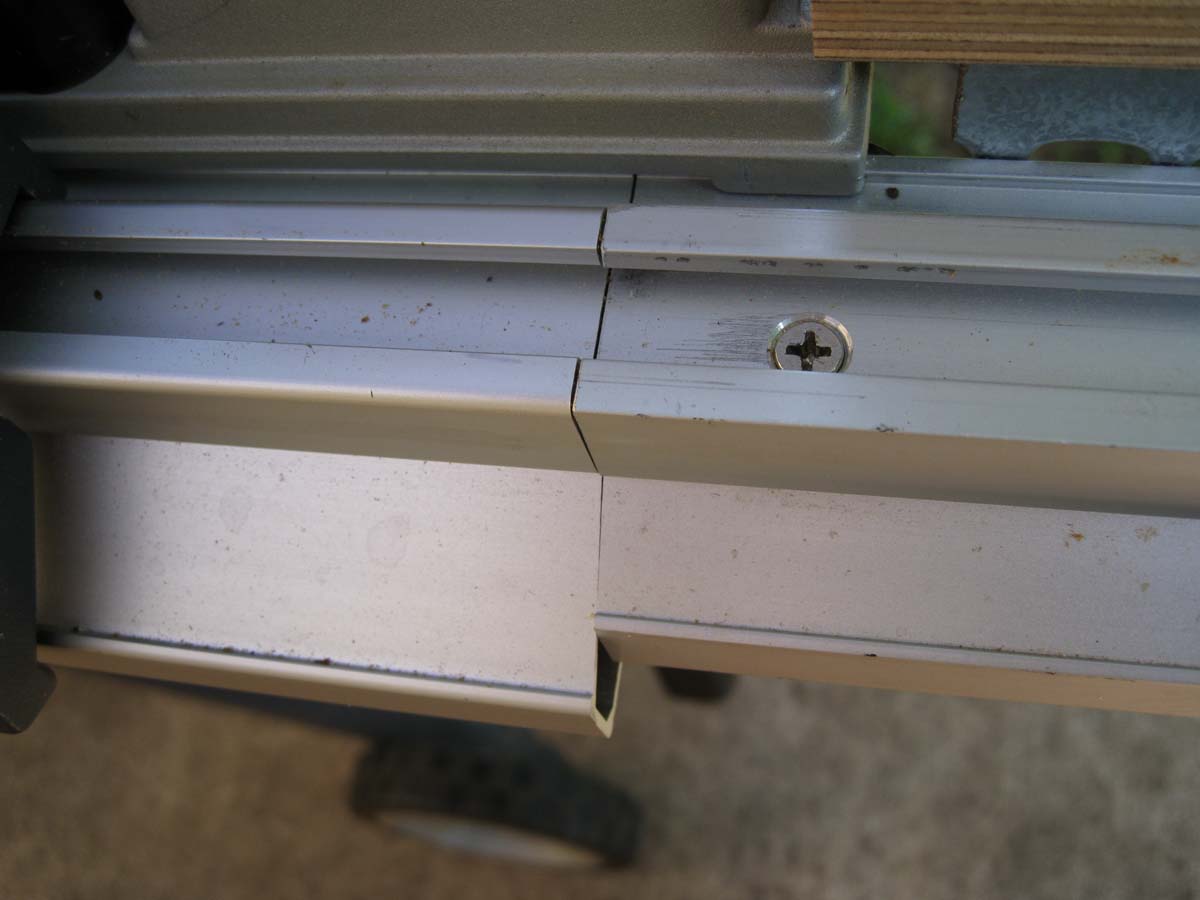

                I didn't use Komatoast's fasteners. His are a lot stouter then the stock ryobi plates. I used two ryobi connectors on the bottom and a hardwood insert. The insert was fabricated by the previous owner of the half rails. You can see the screw through the rail into the wood insert.
                I've got 0 the rail tape set to 10" to the left of tha blade. It will still fold up at 10, but too much further the rails will hit the ground. The half rails have a phenolic plywood router top with a cutout for a jessem route-r-lift FX. The 21829 accessory table and a BT acc. table fit inbetween the plywood and main table. I had to make a leg to hold up the extension. With the router out there it would tip with much downforce. Having a second BT fence is nice if you attach your router fence to it.
                There's some photos in this post: http://www.bt3central.com/showpost.p...92&postcount=7
                  Pictures and description most enlightening.
                  First time I've seen all three together to compare exactly.
                    Photos really do tell a good story. The only other difference, and it's really not worth noting most of the time, is that the 2 outside corners of the top small slot on the front rail are slightly rounded over on the 21829 and BT3100 rails. The BT3000 rails have a profile that is more square.
                    Those two little corners sticking up when connecting the BT3000 rails to the others will occaisionally hang up a fence. A couple pases with a file will help quite a bit.
                    The differences in the extended front when connecting the different profiles do not affect the fence movement. At least that is the case with the casting on the 21829 and BT3100 fences. I don't know if the BT3000 casting is different. I doubt it though.

                      Well, dang. I just presumed the silver BT3000 rails would not connect to the black BT3100 rails. Not sure if I like the looks of it, but it's a table saw not a work of art or even a car. I have a 7 inch section of silver rails I need to look at installing on my BT3100 when I get back from vacation.
                      Thanks for the posts, Pelligrini.
                      - Chris.
                        Chris- You ought to look into doing an insert connector. The plates can be a pain for permanently connected extensions. They are always in the way with my front acc table clamp. They'll probably be easier to fabricate when using all BT rails. I need to redo mine or shim the 21829 ends because of the differences in extrusion thicknesses.

                          Yep, already started noodling with that in my head. It was interesting to see the difference in thickness of the rail extrusion between the BT's and the 21829's. Looks like they 6Sigma'd it and found a way to reduce some cost. Not necessarily a bad thing, but I imagine it's caused us "frankensteins" a little grief as we're cobbling together customized BT3x's.
                          - Chris.
                            Not too many people comment about the extrusion thicknesses, but it's a PIA when you're mating the two with an insert. Aluminum prices were pretty high when the 21829 was introduced. Most of the parts in that model used less of that element. No router plate, thinner extrusions, no ribs on tables, thinner rails, etc.
