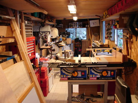

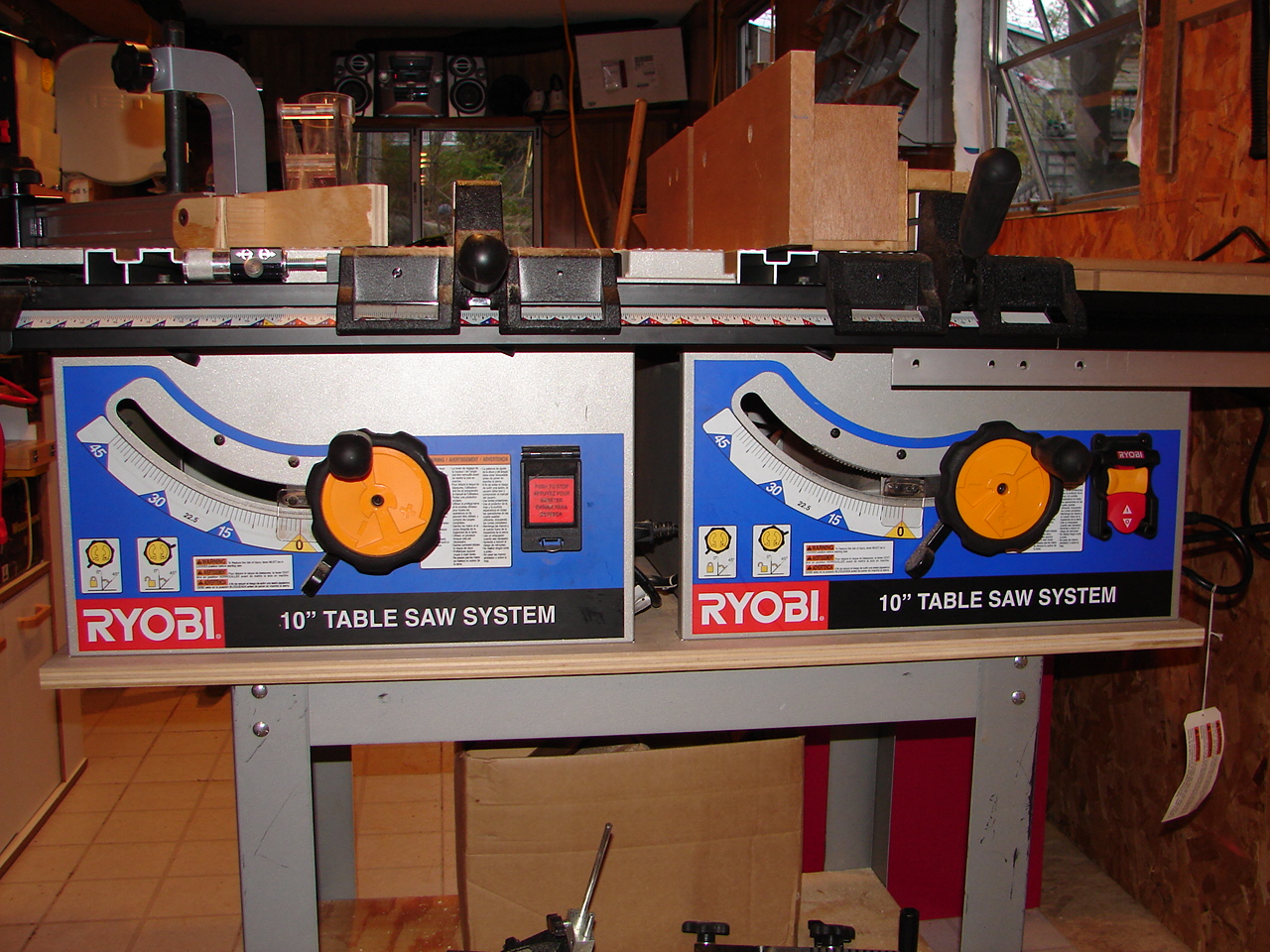

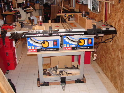

            John,
            Here are a couple of photo'sof my temporary Frankensaw setup. It's been temporary for over 2 years. Someday I will find the time to actually build a mobile base base cabinet for it.
            The saw on the left is set of for crosscuts & rips and the right hand saw usully has a dado stack in it.
            Russell
