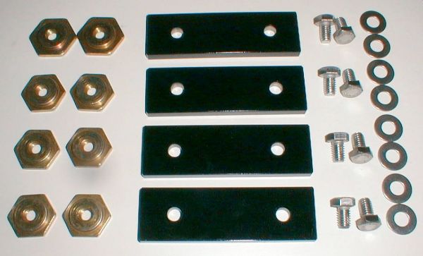

    I've laid my hands on an extra set of rails for my BT3000 and plan to extend the current rails by roughly half.
    I know many forum members have done this. Are there commercially available joining devices to attach the extensions to the current rail.
    If so, it would save me from having to invent the wheel again?
    Thanks everyone!

    There is a fellow member and ebay seller by the name of "Komatoast" (or something to that effect) that sells a joining kit for this ... I personally don't have any experience with his kit.
    Check Ebay.

        Do a search, this has been done at least a zillion times. But an easy way to do it with two pieces of 1 1/2" angle aluminum about 6-7" long. Can't find my pictures right now but I'm sure someone has some. Pat

          And 8 T-nuts plus some appropriate length bolts. 1/4-20 works fine.

            I bought the joining kit, biggest waste of money I've ever made. You can do the same thing by taking a couple of pieces of 1/4" steel and drilling a hole through each end. That's the extent of it. Sure, they're very precisely drilled, but not really any help in joining the rails.
            I went a different route. I spent about 10 hours gluing up and milling 24" wooden inserts that exactly fit the rail cores. A lot of sawing on angles, router work and some hand sanding, but got them very close. A serious pain, but when I slid the rails together with the help of a rubber mallet, they were rock solid. No movement at all. Set the other ends on some homemade t-nuts, and the whole thing is nearly perfect.

                When I did my extentions here is what I did, I stole from this artical. Scroll down to almost the last page. You will find the diagrams for the home made version. I think Rod K has a different aproch that is also home made
                http://www.bt3central.com/articles/files/browning.pdf

                  I made some t-nuts from steel bar stock with attached hex nuts (tack welded by a buddy), then slid them down the back slot. I have a large base with a solid table between the rails, so I was able to mount the homemade t-nuts to the table and then slide the rails into place. With the solid wooden cores on the other end, the whole thing is very solid. I had to stand on it tonight to do some work on my DC ducting, and it didn't even creak.

                          While $29.95 is a bit more than I'd pay, it's not exactly what I'd call a ripoff. KT's kit contains 8 T-nuts which have to be ordered from a unique source, and four metal plates custom cut and drilled, plus the other hardware all gathered neatly and based on knowledge of the proper dimensions. It's also important to have the correct length bolts or they will bottom out before they clamp. For someone who is not plugged into the knowledge this would be worthwhile. Pic attached of the $29.95 solution.
                          Certainly spending 10 hours milling wood parts and having a welder tack-weld some nuts to another cut plate, lets assume it took 1 hour to find the nuts and cut the plates and tack weld them. Total of 11 hours at a minimum wage of $5 = $55, almost twice the kit price. I venture to say for most of us our time is worth more than $5/hr.
                          Maybe the wood cores fit perfectly but the kit should be quite solid.
                          I would not call it a ripoff. That's a little harsh.
                          I've no connections to Komatoast. I stole his pic for this post.

                            KT's kit contains 8 T-nuts which have to be ordered from a unique source ...
                            Note that the listing for this kit does NOT include any T-Nuts just to be clear ... they are not part of the auction item as listed ... but can be ordered for extra $$$.
                            FWIW, I've looked at this kit in the past and I'd say it's quite clear what you are getting ... hence the reason I opted for getting my shop at work to make some for free out of scrap cuts ... however, as Loring mentioned for someone who hasn't got the option of getting them made elsewhere or they don't have the tools to DIY, I'd say that $25 is worth it ...

                              Apparently he offers more than one kit.
                              the listing currently on eBay for $29.95 includes 8 t-nuts from t-nuts.com
                              (adds the 8 t-nuts for $5 to make a full kit)
