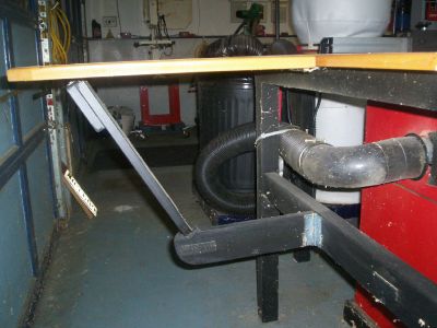

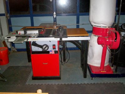

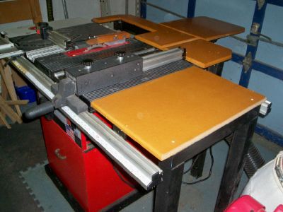

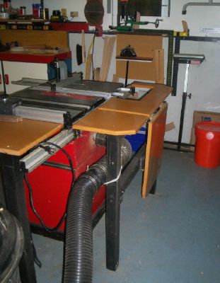

            Evening VR..
            I have the right extention table anchored to the MDF extention with 3 sheet metal screws. I drilled 3 holes in the of the actual BT extension table lip and tied the MDF to that outside end with the 2 1/4" X 2 1/4" legs supporting the other end. Rear extensions are done similar.
            I had no pre-existing plan with the exception of a cup of coffee and deep thought as I stare at the objective. In other words.. "wing it" as ideas will come if you stare intensely enough and drink enough coffee! ha.. ha...
