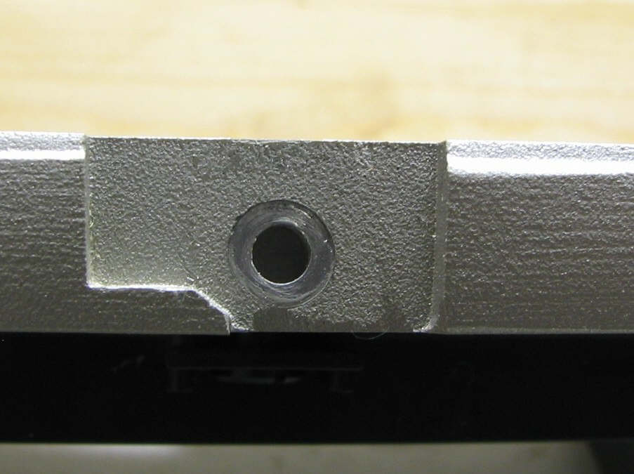

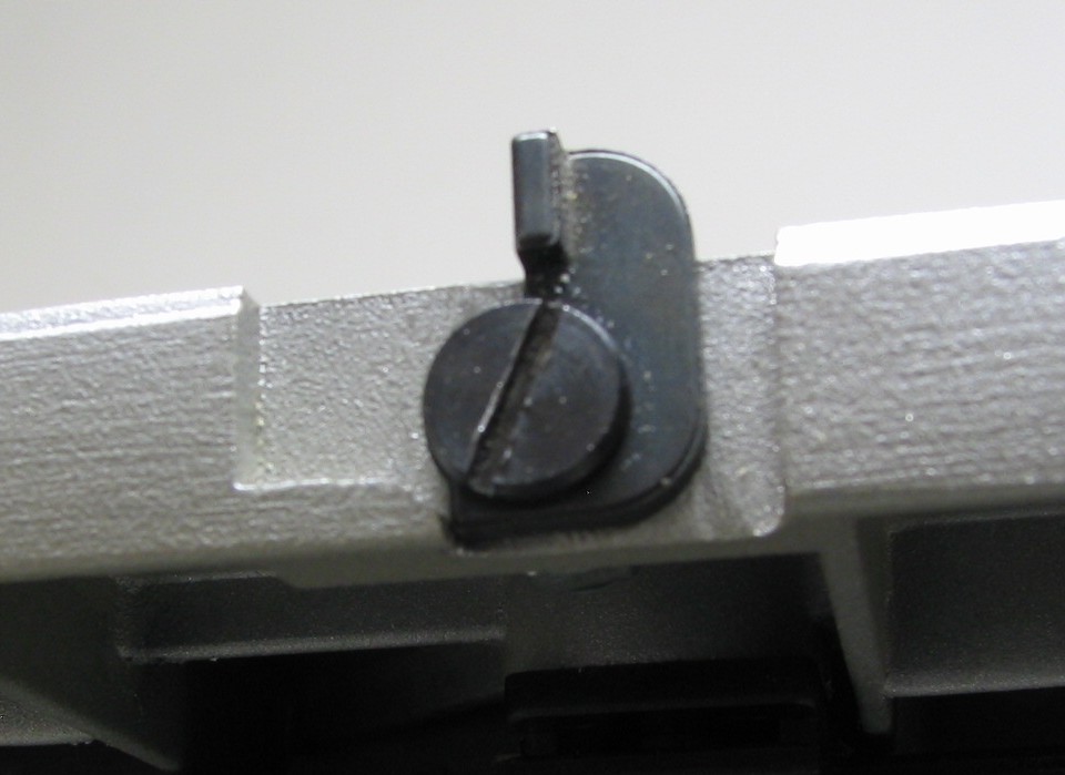

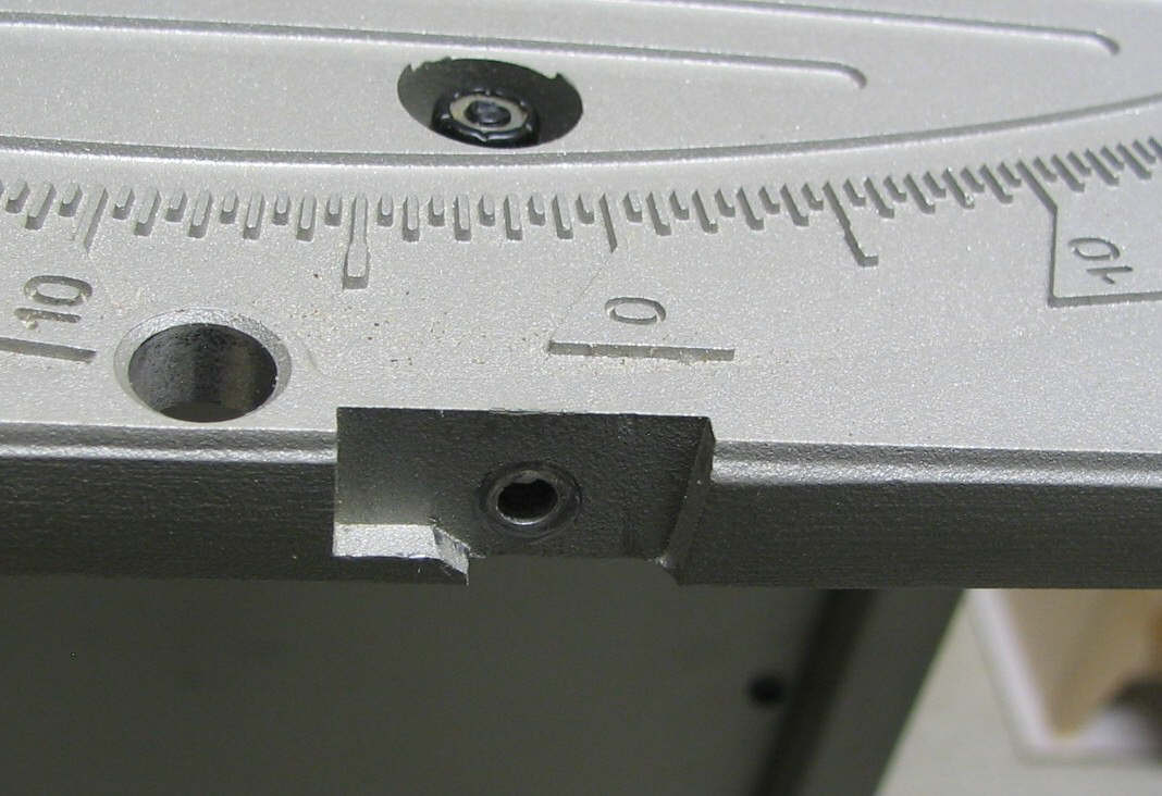

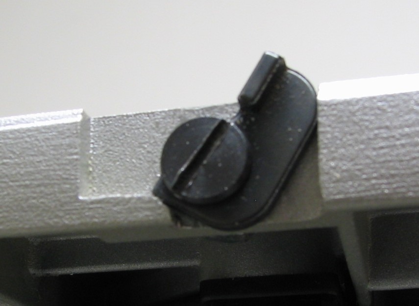

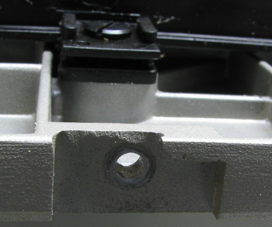

                    Folks, thank for all your replies. I went to HomeDepot twice today, once to look at the Quick-Stop on the BT3100. The second time, with tools and SMT in hand.
                    I believe the casting for the SMT was not finished correctly in addition to the hole for the Quick-Stop being slightly off . The SMT at the Homedepot look as it was slightly milled/filed near/at the Zero-Stop hole, mine has none. Also the eccentric screw worked fine on their table but not on mine. (Roybi Customer service is sending me a new eccentric Screw and tab for the Quick-Stop before I went to HomeDepot)
                    Can’t deicide if I will exchange for a new BT3100 at HomeDepot or have customer service send me a new SMT table? Don’t look forward to aligning SMT for PARALLELISM.
                    Exchanging at HomeDepot, hate to have to realign and lubricate, serious I think they forgot to lubricate everything except the Spring Shims. And the worse case scenario, the Saw having the same problem if I exchange.

                          Your SMT notch looks damaged. The stop should not rotate past upright as it is shown on 2nd photo.
                          I suspect you might have gotten a unit somebody used and returned. My saw came out of the box properly lubricated and almost dead-on aligned (only rip fence needed a minor adjustment.)
