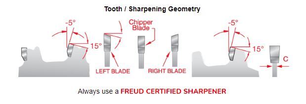

    NG, the outer blades in this set have a beveled tooth for making a splinterless cuts with little tear out to the edge of the dado. There's a specifically right and left outer blade they are NOT designed to be used singly.
    The inner chipper blades are flat tooth grind. From Freuds website: Click image for larger version  Name:	Freud SD206 blade geometry.JPG Views:	0 Size:	15.3 KB ID:	845360
    The resulting dado is flat and clean across the width but there will be a little tiny bats ears gutter at the outside bottom of the cut due to the outer bevels.

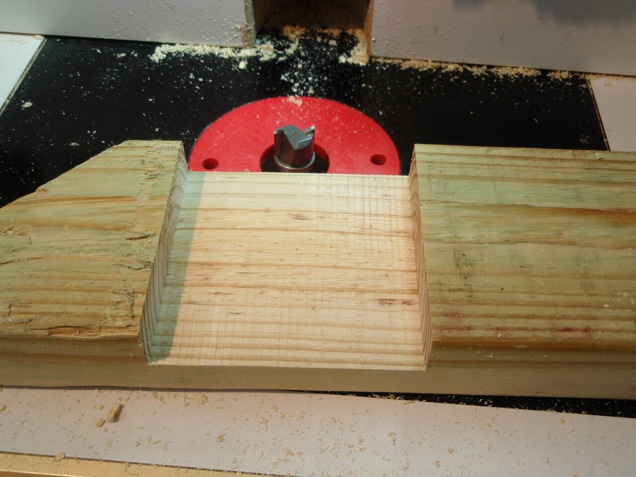

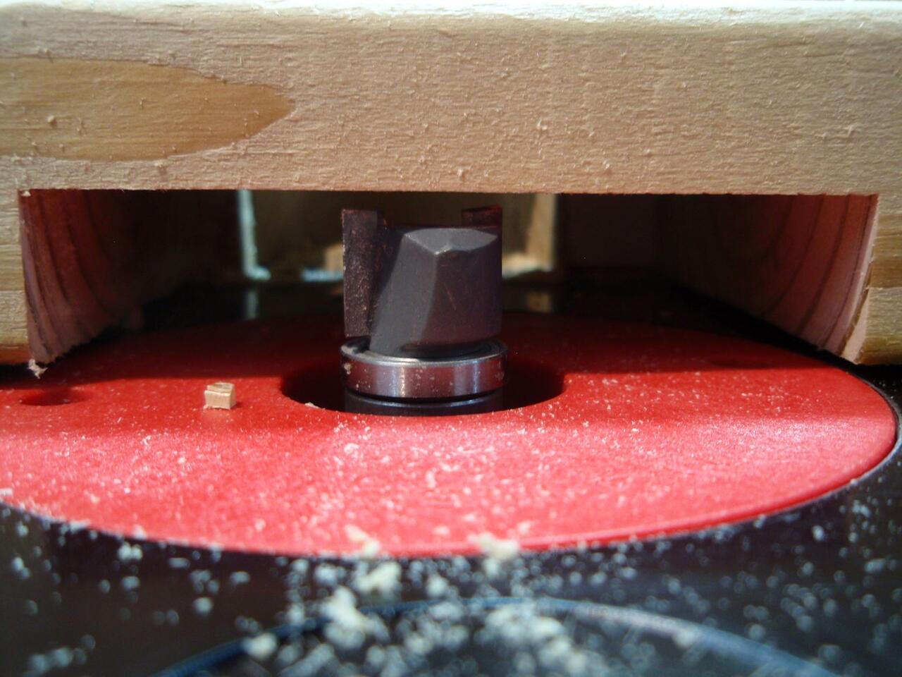

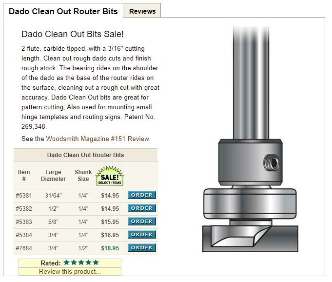

        You can use a router bit called a dado clean out bit to truly flatten and square the corners of the bottom of a dado groove.
        Click image for larger version  Name:	Dado clean out bits.JPG Views:	0 Size:	59.3 KB ID:	845387
        you would use the 31/64 to clean out a 1/2" dado whose bottom is less than 3/16th variation and the sides are perfectly clean.
        Unfortunately I don't see any for narrow grooves less than 1/2"

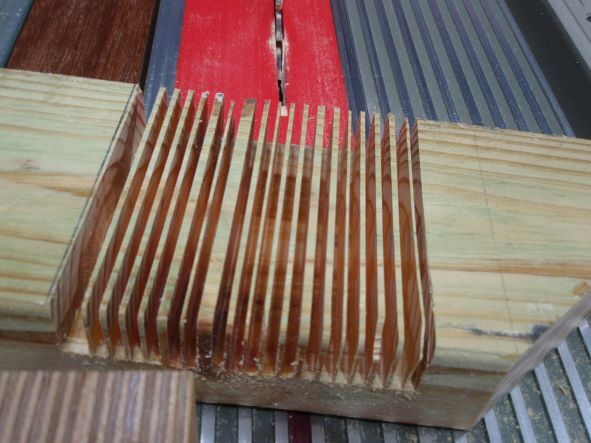

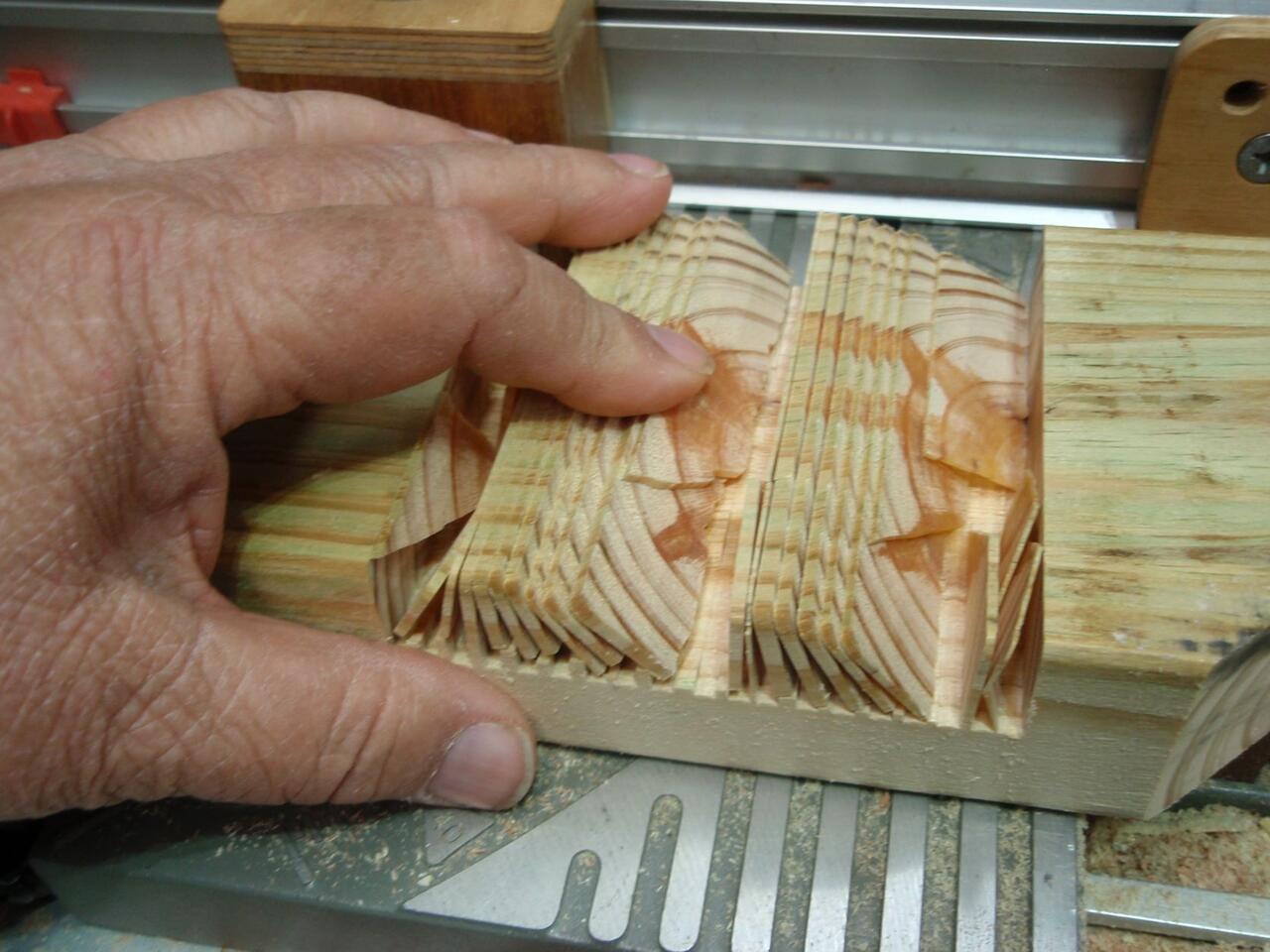

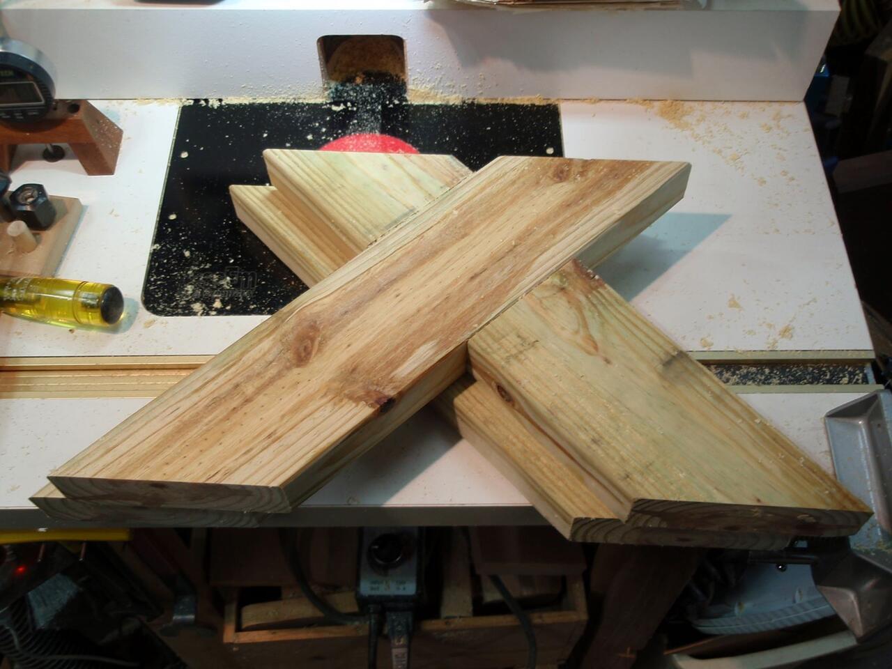

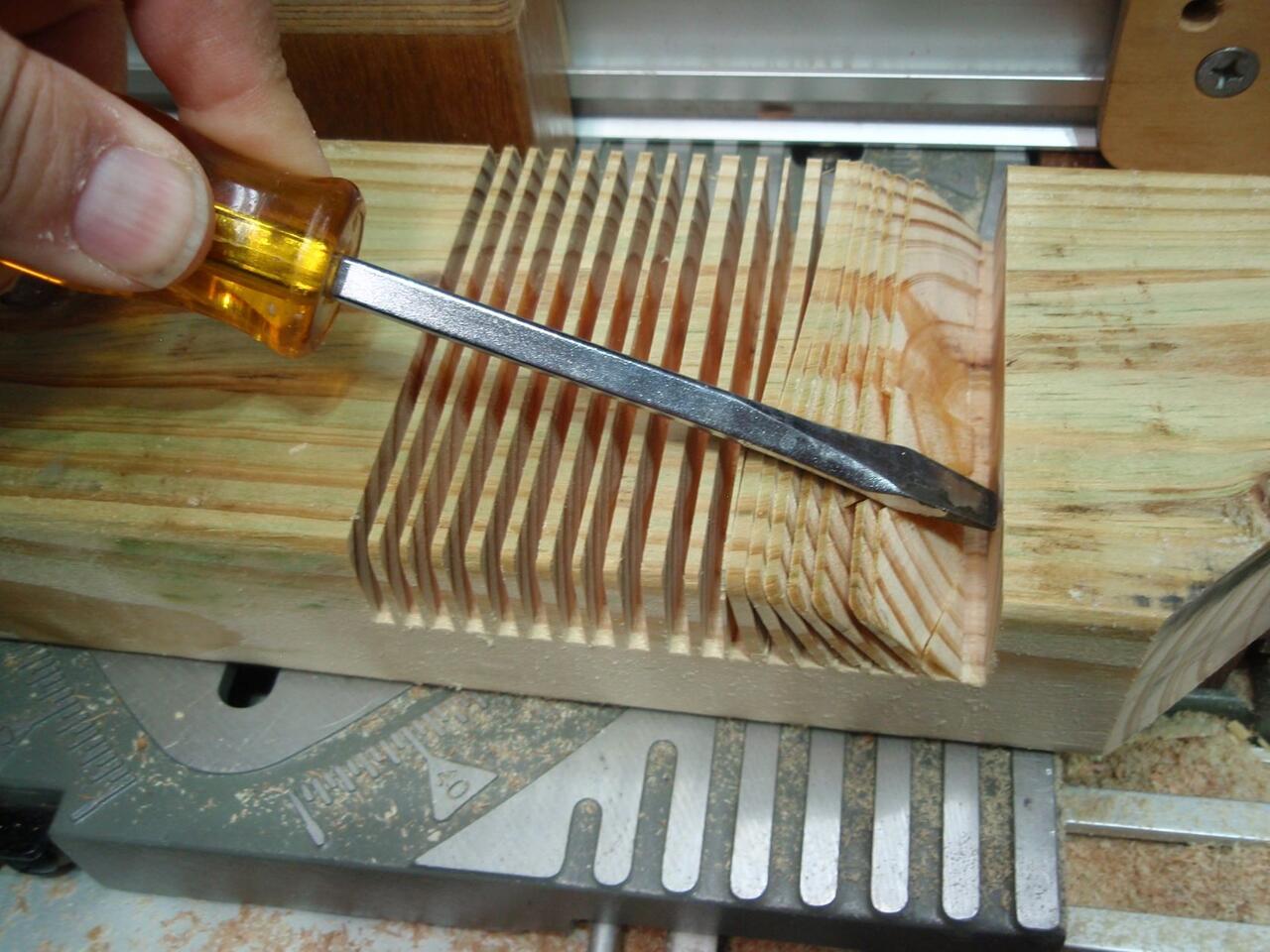

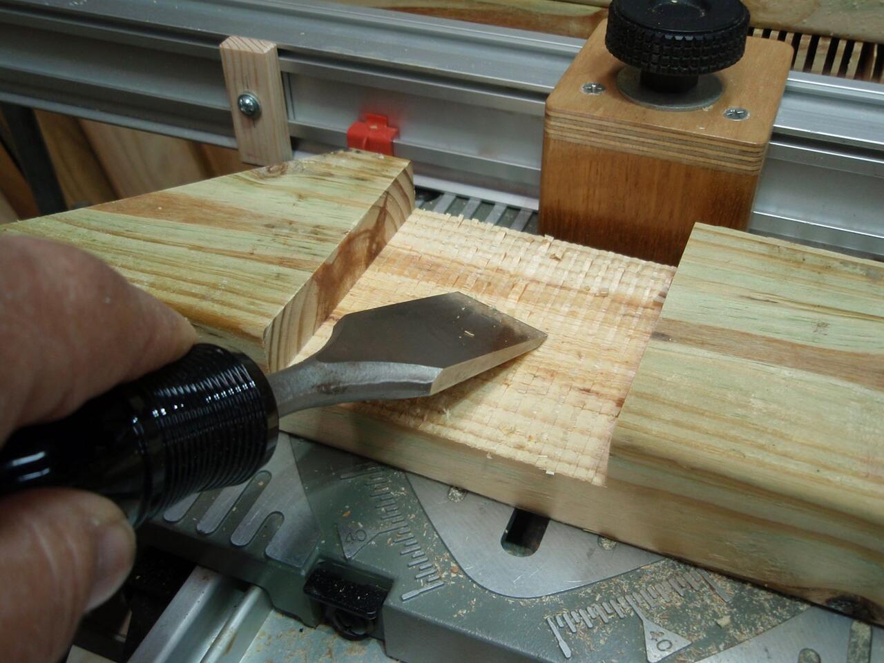

        I regularly use the #7684 in the router table for doing half laps that are 3/4" deep and 3.5" wide (2x4s) after quickly grooving a hair less than 3/4" deep with a regular saw blade. I use the TS to cut the edges carefully then make many parallel 50% cuts by eye. Break off the resulting fins with a screwdriver, (optionally) chisel off any big remnants and then finish with the dado clean out on the router table, zig zagging across the width.
        This is faster than putting in a 3/4" dado on the TS and making multiple passes. Surprisingly quick.

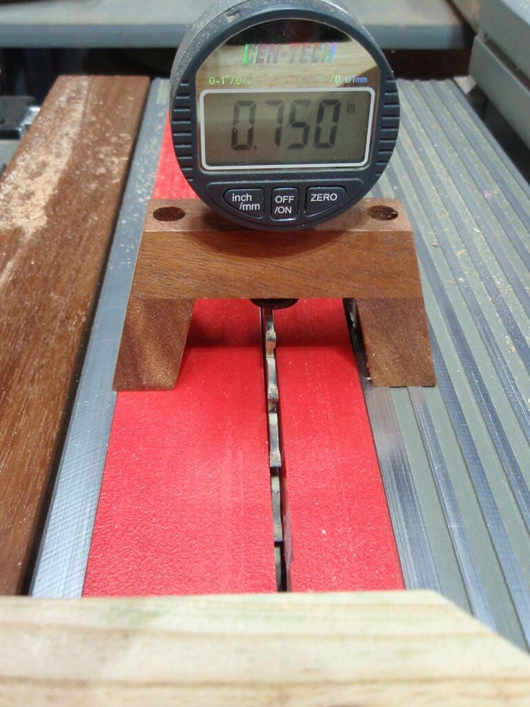

        On this one I made the initial saw cut the exact depth which is why you look closely you can see striping of the ATB bevel edge cutter teeth. If I had made the saw cut 1/32nd less or .730" then you would have an astoundingly smooth clean bottom with the dado height set to 0.750"

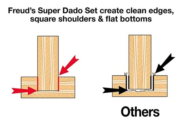

          On the photo of this blade the 3rd line of description says it cuts a true flat bottom groove.
            LCHIEN commented
            but if you look at the blade geometry you know it can't.
            Does personal experience count?
            Advertising hype. Mostly flat bottom. The Titanic was mostly unsinkable.
          From the Freud-supplied images on Amazon, look closely at what they are calling a flat bottom... you can see the little grooves in the corner they are clearly referring to the other competitors' uneven bottom when they say flat bottom. Not completely square.
          Also note the splintering they are claiming to avoid with the bevel top side cutters.
