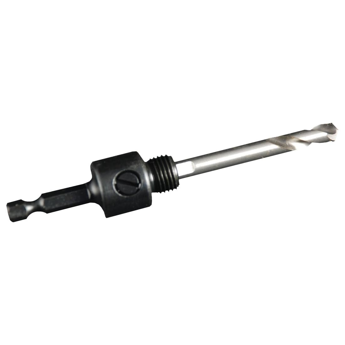

                        I have an arbor from Bosch that works (screw in sleeve setup with a quick release) and standard screw in type (no name) and lastly a Milwaukee screw in type that also has two pins that set in. All of them work with this holesaw. What brand(s) do you have that arent working? Nearly every mandrel or arbor will fit this bit.
                        The images below correspond with the list above.

                            the hole saws i have are like cups. They have a hole with .690 or .545 dia and two opposing flats to keep the arbor from spinning. They have a nut which pulls the arbor thru the cup and compresses against the back. A lip on the arbor keeps it from pulling thru the cup.
                            I see the Lenox hole saw has a threaded hole in in the saw and the arbors pictured thread into this hole from the outside. None of my arbors have a threaded portion which will thread into the saw body.
                            I think i have cheap hole saws.
                            This article explains the threaded mandrel systems to me.
                            http://www.ereplacementparts.com/art...ing_Guide.html
