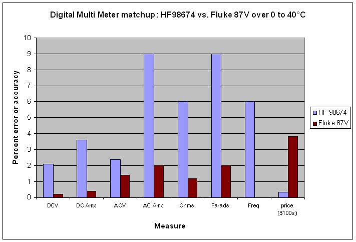

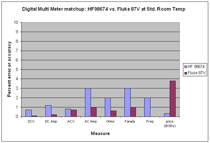

        Engineer goes crazy comparing specs, are they fair specs?
        My curiosity led me to compare these:
        HF 98674 compared to a Fluke 87V which costs about 10X as much
        Accuracy:
        DCV 0.7% vs 0.1%
        DC Current 1.2% vs .2%
        ACV 0.8% vs 0.7%
        AC Amps 1-3% vs 1%
        Capacitance 3% vs 1%
        Resistance 1.2 to 2% vs 0.2 to 0.6%
        Frequency 1.5-2% vs .005%
        So in many areas the Fluke is quite more accurate.
        But for many of you it won't matter. It's good enough
        and the HF also allegedly does luminous intensity and sound intensity and temperature. The Fluke has temperature capablity, too.
        OTOH the Fluke has min, max and other stuff which is real handy for keeping track of sags, surges and drifting.
        HF operating range 0-40C vs FLuke -20-55C
        Temperature performance:
        Over 0-40C, DCV error 2.1% vs. .2% given:
        Temperature coeff (e.g. change in reading vs change in temperature) HF .1xaccuracy/deg C Vs. Fluke .05xaccuracy/degree C (i.e. HF temp drift for DCV may be as much as 14X given the 7x better initial accuracy of the Fluke) At 0 C or 40C the HF would be off by another 1.4% (total error 2.1%) vs .1% more for a total of .2% total error for the Fluke. The HF is not guaranteed beyond 0-40 C it would probably work but the accuracy would really go off. The Fluke is guaranteed to work -20 to 55C a whole lot more, and with much less error than the HF.
        0C to 40C is 32F to 104F;
        -20C to 55C is -4F to +131F
        The FLuke is also more rugged, electrically speaking:
        withstands 1000VAC or 1000VDC in all modes and ranges whereas the HF withstands 1000VDC or 750VAC in higher ranges but only 250VAC in the lower ranges - this is a whole lot easier to destroy.
        Anyway there you have it. The HF at $32 is a meter that's good for casual use, a home owner probably won't need the accuracy, use it outside of 32F to 131F, and there's no voltages in a house over 230VAC so 250VAC max overload is OK. If you only measure AC Volts then the Fluke is only marginally better than the HF. The Fluke costs more than 10X (I think around $380) has a lot more accuracy for virtually all modes and ranges, a whole lot more temperature stability and is electrically more robust and should be the choice of a professional electrician or electrical engineer, even at that price.
