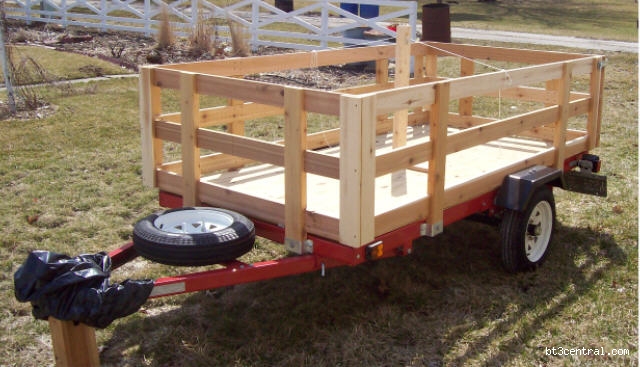

    I have had that same trailer for close to 2 years. It has done a great job for me and I have been very happy with it. It is set up so that it does not fold. I did not put the hinges on and bolted the 2 parts together and did not cut the plywood deck. I do not have room in the garage for it folded up and I have space to park outside.
    Some things I remember from putting it together.
    * Take your time reading through the instructions. They are not very clear on a lot of things.
    * Run a ground wire with your lights. They rely on the metal frame for the ground but with paint you may have issues.
    * Clean and repack the wheel bearings. I read that on a forum somewhere. It is a lot easier to do it before it is assembled.
    Here is a picture of mine assembled. The wood is all cedar (decking is PT ply).
