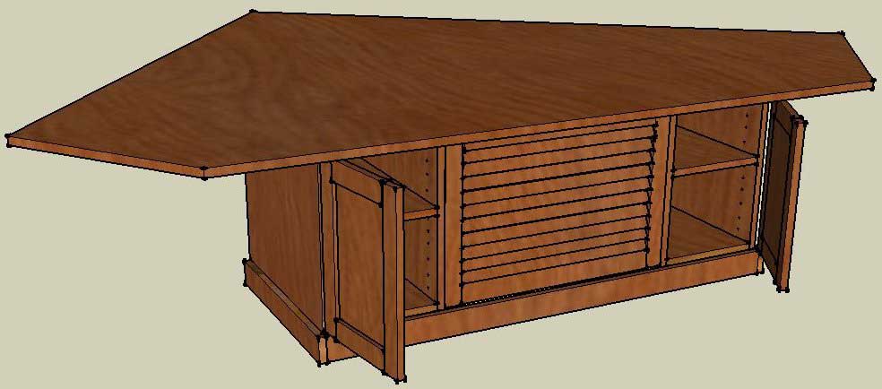

        First try with Google Sketchup
        I thought I'd try to draw the project I've recently completed using Sketchup to see what it was like to use. I've been quite impressed with it overall, especially when compared to CAD programs (which I know it's not). After a very brief look at the included tutorials, I dived right in and was pleasantly surprised at how good it is. I had a bit of trouble figuring out how to attach one form to another, so I must do some digging on that.
        Here's the 2D export from my effort (click on it to enlarge):

        If you would like the Sketchup file (215Kb) to play about with in Sketchup, drop me a PM with an e-mail address and I'll ping it to you.
