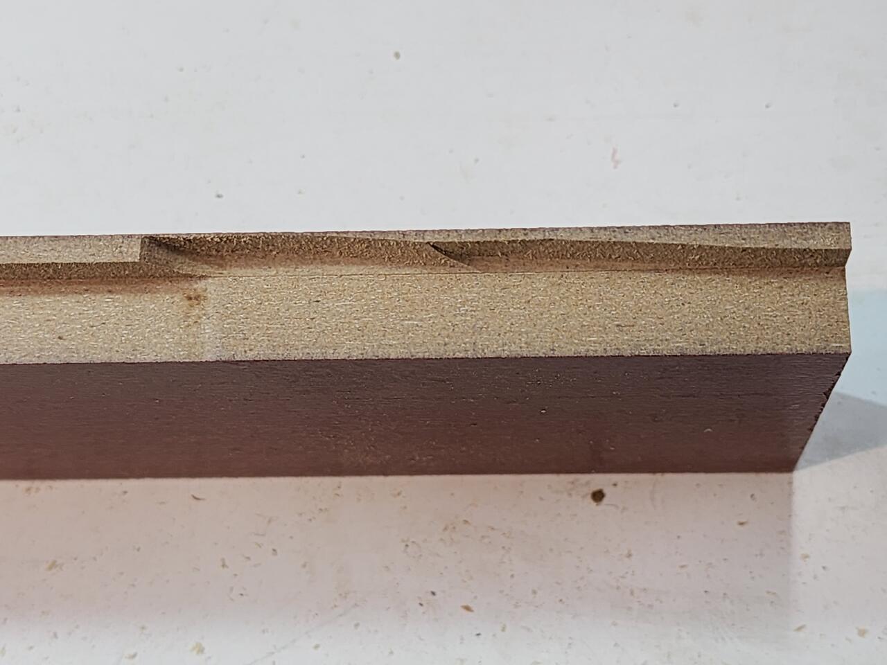

            Ok, here's stupid trick number two.
            jessem router lift, Bosch 1617 router 1/2" dia carbide upcut bit.
            Test cut (at least I'm smart enough to do that). The bit keeps climbing over a cut of a few inches, the thin overhang was to be 1/8". The piece was 1/2" thick.
            Click image for larger version  Name:	20260114_222320.jpg Views:	0 Size:	96.0 KB ID:	862428
            After mulling it over and theorizing my router shifted or the lift shifted, I decided it must be the bit and collet. Probably not tightened enough and the spiral uncut pulls the bit away from the router making a deeper cut.
            Tightened the bit and had to reset all the settings, worked like a champ.
            I don't normally overtighten my router bits, just a small amount past where finger tight stops. Guess I should use a bit more... don't use spiral bits that often on deep cuts. The spiral fluting causes some extra upwards force on the bit that you don't normally get with non spiral bits.
