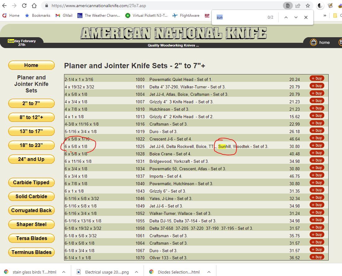

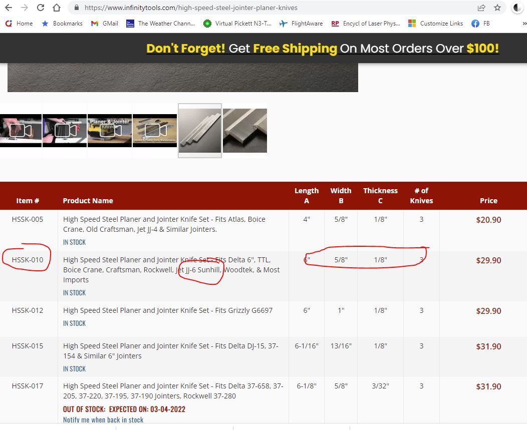

              • 22025
              Dave...
              https://www.americannationalknife.co...4aAoAUEALw_wcB
              https://www.infinitytools.com/high-speed-steel-jointer-planer-knives
              Click image for larger version  Name:	sunhill knives.JPG Views:	0 Size:	163.8 KB ID:	848766

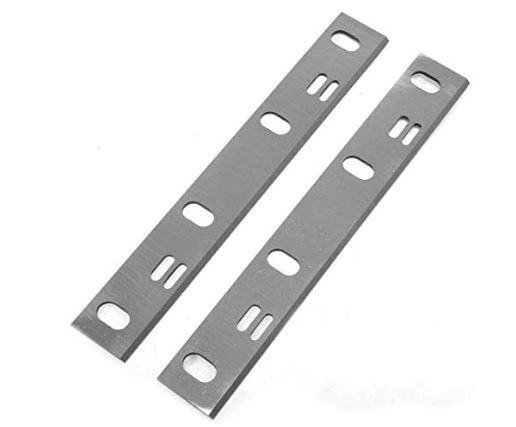

                  Please see the image of one of the last jointer knives. And no those jointer knives listed are for the floor model, not the bench top.
                  The knives are VERY similar to some Delta models but the horizontal slots are too close to the cutting edge compared to the Delta...

                    Now that you posted a picture and description...
                    How about these at Amazon
                    https://www.amazon.com/dp/B08M3SPTXP...d_asin_1_title
                    Click image for larger version  Name:	fox jointer knives.JPG Views:	0 Size:	14.0 KB ID:	848816
                    Dual set of Jackscrew points, one set looks like yours, 6" and the holes look evenly spaced.

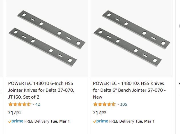

                    or these
                    https://www.amazon.com/6-Inch-Jointe...7D6B9W1Y&psc=1
                    Click image for larger version  Name:	Wen 6560 jointer blades.JPG Views:	0 Size:	13.9 KB ID:	848817

                      Before I commit to replacing the jointer, I was planning on trying a set of those. That looks like the ones for the Wen knife type jointer, I believe the dimensions are right, 6-3/16" w x 7/8" h x 1/16" d. The big question is are the indexing slots in the right place?
                      I think the only way to find out for sure is buy a set, install, or at least try to install, rotate a couple of times to insure no interference, and then IF all that goes well, test...

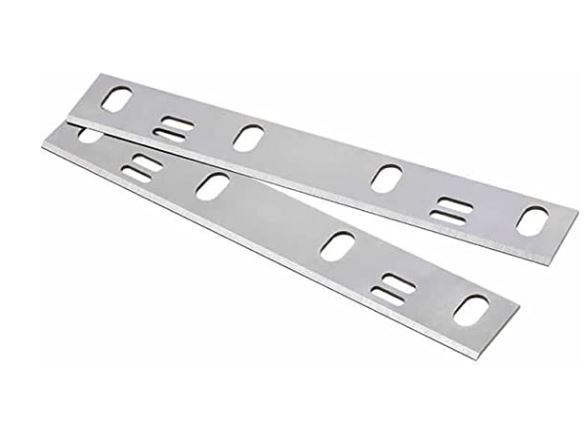

                        • 9525
                        pavensoon and anyone else interested in this.
                        I have not fitted them yet, but I ordered a pair of these...
                        FOXBC 6-Inch Jointer Knives Replacement for Porter Cable PC160JT PC37072 - Set of 2
                        https://amzn.to/35BkRW9
                        kives
                        Comparing back to back, all dimensions, and critical holes line up perfectly.
                        Unfortunately I won't be camping this weekend due to a forgotten obligation but maybe later in the week. As long as I can get 4G since I work remote...
                        Anyway, while they have an extra hole in them, I am 99.99% certain these are what I need for this jointer. I will at some point shortly swap them in make sure they are set up right, no interference etc... and try them out.
                        If they work, my plan is to grab another 4 or 5 sets so I won't have to worry for a few more years...
