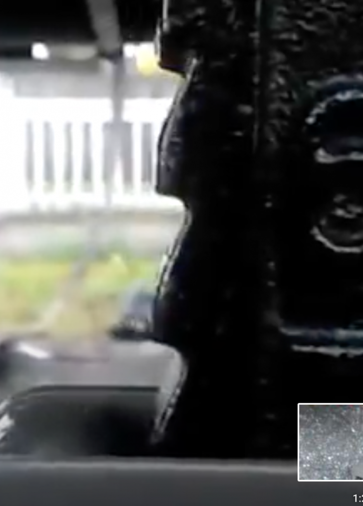

      The orange ones are fine. The red are not, and SOME gray ones are not. It's about the tooth shape, some have a flat surface that rolls off instead of a hook shape. Some idiot probably thought they could save a buck on the molds.

            If you glance at the hooks, you can see the ones that are made incorrectly are shallow and appear as if they will push the pawl off themselves. Good ones are deeper and with a little bit of hook.
