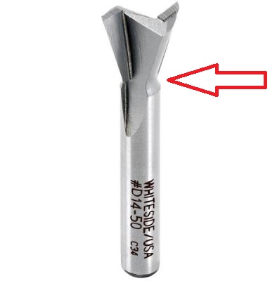

              Dovetails bits can be extremely fragile - the neck on the common ones used for the dovetail jigs have an extremely thin section that will break with sideways pressure, much moreso than all the other bits.I seem to recall that it's thinner than the 1/4" shank.
              If the bits are dull or the cutting pressure too great they will break quickly.
              This is the Whiteside 1/2" 14° 1/4" shank dovetail bit, the type I think is commonly used for dovetail machines.
              Note the undercut just above the shank where the bit is very weak. They usually break right there.
              Click image for larger version  Name:	dovetail bit weakness.jpg Views:	1 Size:	16.1 KB ID:	826965
              Note that the flutes also extend down and cut significantly into the 1/4" shank.
              It wouldn't surprise me that the metal cross section area in the narrow necked part is half the metal cross section area of the main 1/4" shank, making a very weak point.

                  The dovetail bit actually broke midway up the shaft - right where it entered the router collet. The straight bits did break off at their weak point.
                  All but the second dovetail bit that dulled were essentially brand new bits, but they were purchased years ago (at least 5) so I don't really expect them to replace them due to the time since the sale happened.
                    Now that you mention it, I only got a few drawers done with my HF DT jig before the bit snapped at the neck like yours. I got the Rockler bit and the rest was OK.
