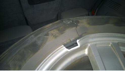

    I hit something going 70 MPH on IH610N yesterday. I managed to avoid it with the front wheel but it punctured the sidewalls of the rear tire in two places and it also punctured the Alloy rim taking a big chunk out of it.
    So I know the two 3" x 1" punctures in the tire sidewall are a death sentence for it. My first reaction was that the rim is toast also. My tire dealer told me he would need to order a new wheel from Dodge for around $500 and who knows how long delivery. I suppose used wheel dealers would also likely have the Dodge OEM rim but the tire dealer said he would not do that so I would have to find one.
    I found in the web an www.wheelsamerica.com place both national and local and sent him the picture above and he said no problem to fix it. The had a number of pictures in the gallery of repaired rims.
    They said about $135 to fix the wheel. On their website they also has what looks like the copy replacement for that wheel and costs like $212.
    Is this a good idea? Is a repaired rim safe?

    Same thing happened to me this past year. NE San Antonio on I35. After checking around, i.e. new at dealer, wheel taken off car at Discount Tire, and checking on line; I bought at WheelsAmerica. Went right to the shop in Schertz and looked at what was being offered. I bought a OEM wheel which had been damaged, but repaired. Looked perfect. I couldn't find any place that had been repaired. Product was guaranteed. The price was the lowest of any of the places I had checked. I've had absolutely no issues with it.

        I believe that the vast majority of aluminum wheels are cast. I don't think they have any special heat treatment. If that is true, then I don't see why they couldn't be welded. If the welds are not annealed afterwards, there would seem to be some possibility they would change shape a little later. I would view a welded wheel to be a little more risk than a new wheel. A used wheel could have been repaired previously so I don't know if it would actually be lower risk. But the chunk out of your wheel looks pretty big to me. That would make me think hard about a different wheel.

            No, I would never have an alloy rim repaired. Too risky, and too easy to replace with a good rim.

                  Given today's welding technology and where exactly on the wheel the repair is being done, I think I'd give it try. If the repair were down on the hub or in one of the spoke/support areas, it would be more of a problem I think. Looking at your picture, the rim damage is pretty localized, or so it would appear. I think at most, a failed repair would only result in leakage at the tire bead.
                  The company is providing a lifetime guarantee, and I don't think they'd do that if they didn't have this type of repair well within their confidence.

                      My daughter had not one but two damaged wheels in the past three years. I read that once bent (especially torn) they will never be as strong. I too found that the dealer wanted around $500. I did a search online and found a new aftermarket wheel for just over $120 delivered. Try rockauto or carparts and do a google search.
