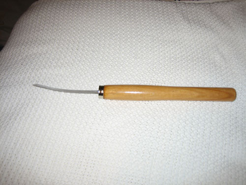

    Chris' recent post about lathes and turning tools reminded me of the set of HF turning tools I bought about 3 years ago. There were 8 tools for $10.00 and with the 20% coupon, they cost me $8.00 or $1.00 per tool. I bought them to learn how to sharpen and they served that purpose well. However, while I was looking for good tools I used the set of cheapos. This is what happens when you get a catch with a $1.00 turning tool.

    I don't do that much turning, and my set of tools are likely similar to yours. I don't know that much about turning and when I got my lathe I picked up a cheap set of tools at a flea market. I think they were $20 for 10 tools. I figured I'd start off with a set like that to learn. I'm just going to offer a guess that it may be where you position the tool rest with relation to the subject piece and the tool. I've never had that problem. I do make sure that the tools are very sharp, and I try to keep the speed and the tool angle right, along with not digging too deep. You could likely take the tool to task with a hammer and a steel plate and pound it back into shape. Maybe not.

      Yeah, the tool rest was too far from the cut I was making. I was doing a deep cove and I only had the one long tool rest that came with the lathe so I couldn't get it any closer. I was experimenting since I was new at the lathe. That was my fault but the tools really are pretty poor. I've read their more expensive sets are not bad. In any case, I now have some Sorby tools and some shorter tools rests with which to work. Just thought it was funny how this thing bent.

        a little more hook in that thing and you can use it for bowl hollowing.
            I've never done any bowl work. Is that called a "hooker?"
