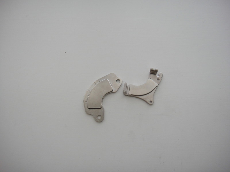

        Here is a pic of some that I have already removed. The magnet is glued to a piece of metal. I once tried to remove it but the magnet broke off. It was still usable but not the size that I wanted.

          I've had some nasty pinches from HDD magnets. Those are rediculously strong...

              Are you able to cut permanent magnets with a metal-cutting bandsaw to make them more manageable in size and strength?
