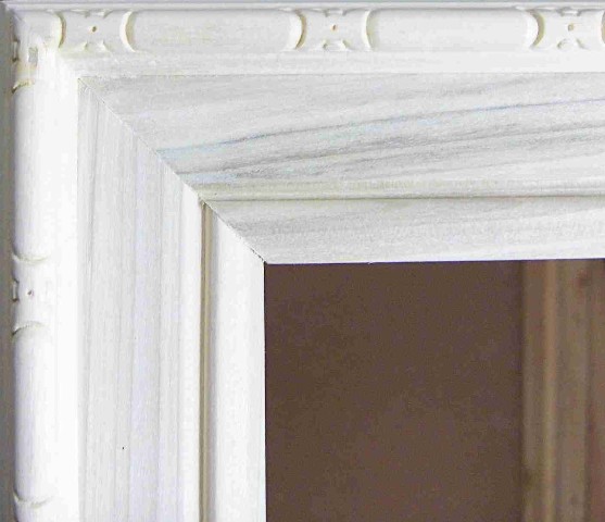

                      That's sounds like a very tall order to find Chop! You may have to make your own. Another idea to dress it up more, since you don't have a router table ready to go is to the decorative molding that the box stores sell, like rope molding or dental molding. Glue it on to your rails before cutting to final size.
                      Here is a pic from one I made a long time go with this method.
