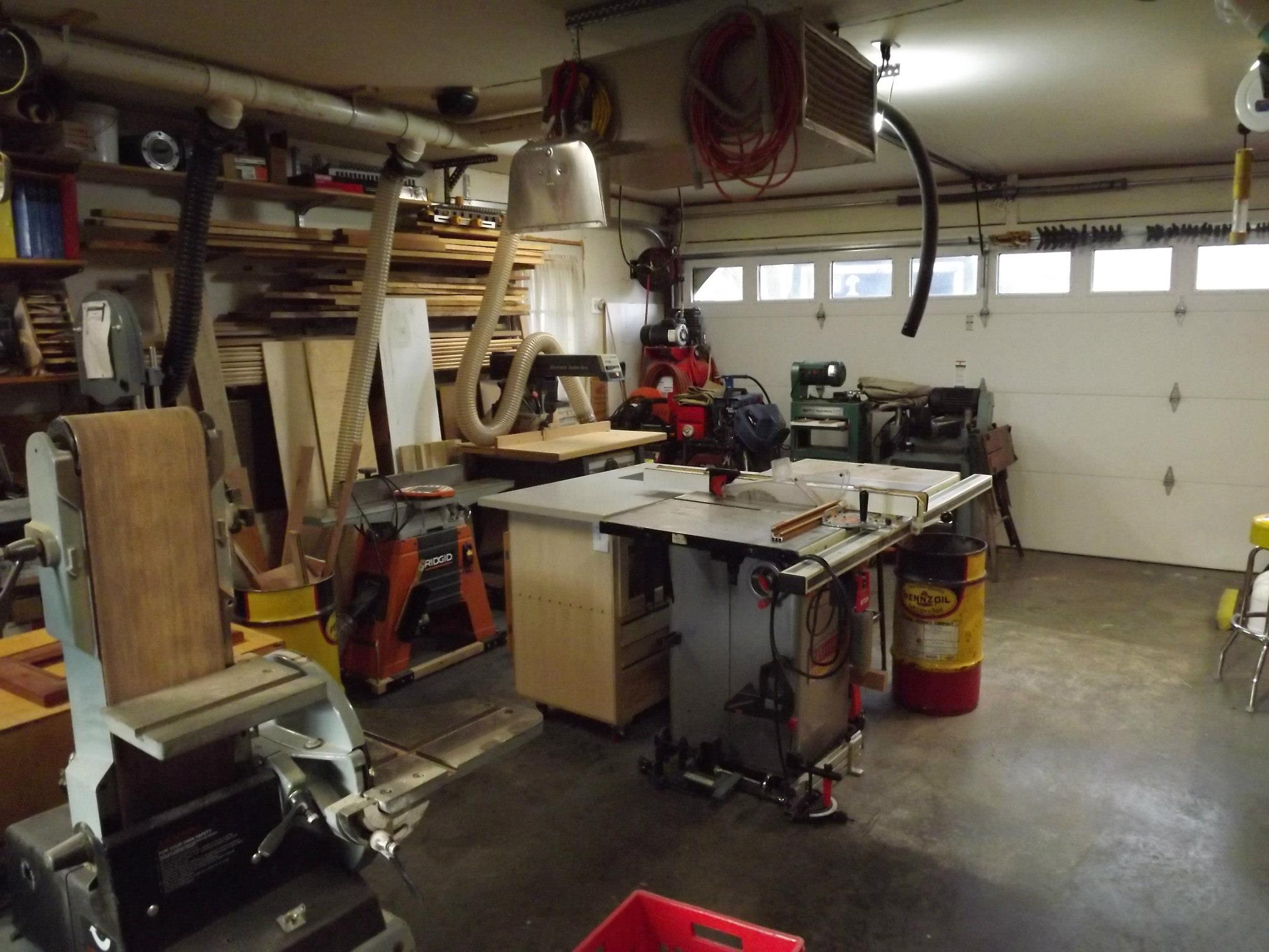

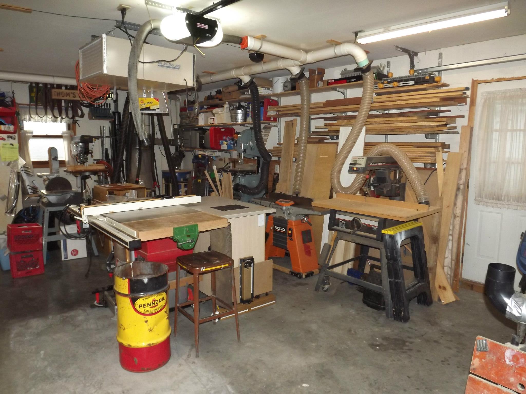

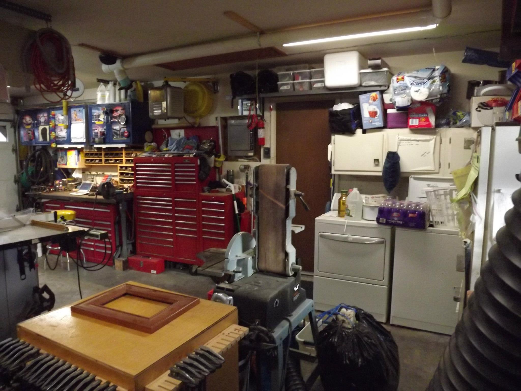

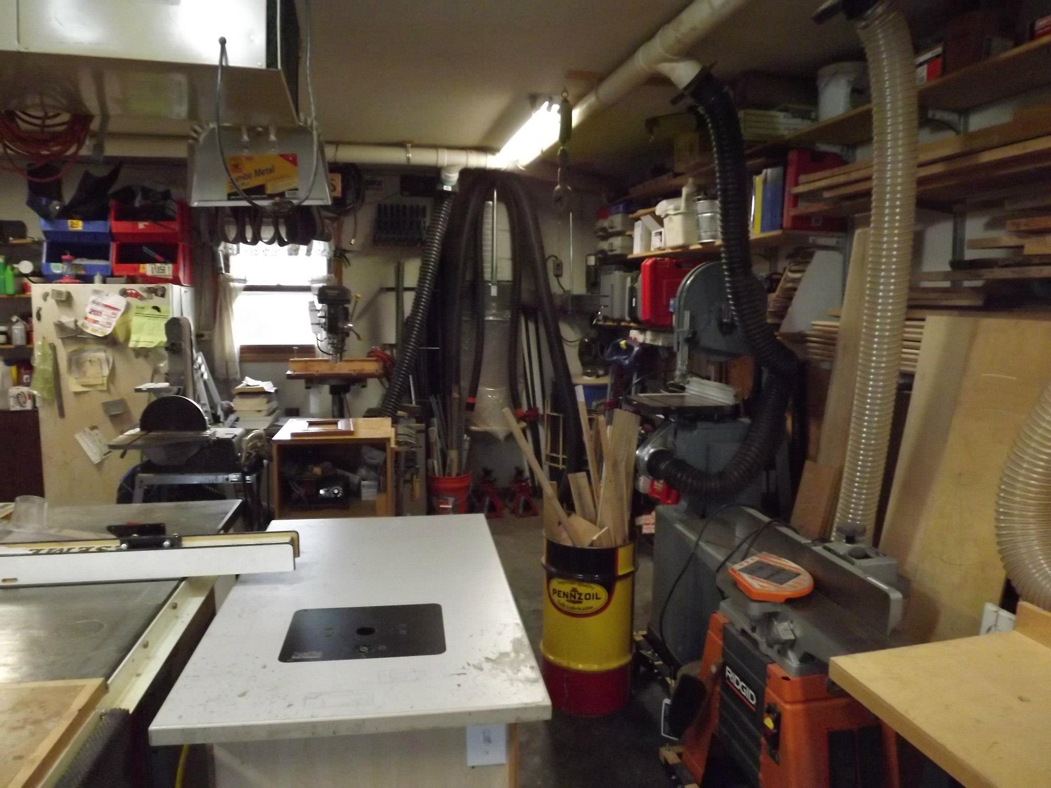

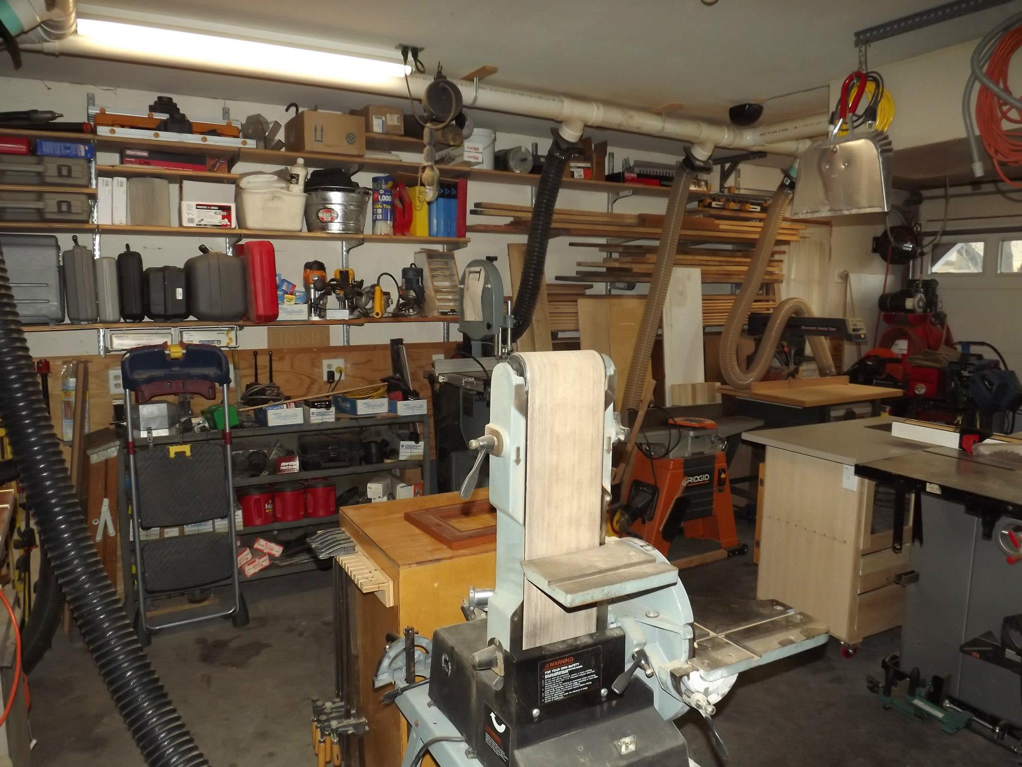

    Shop Shots

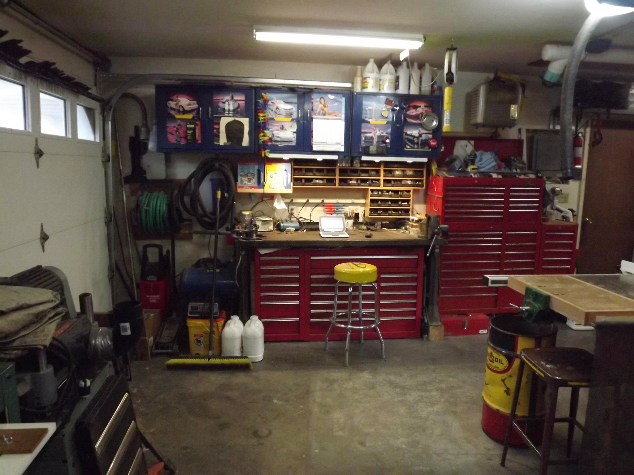

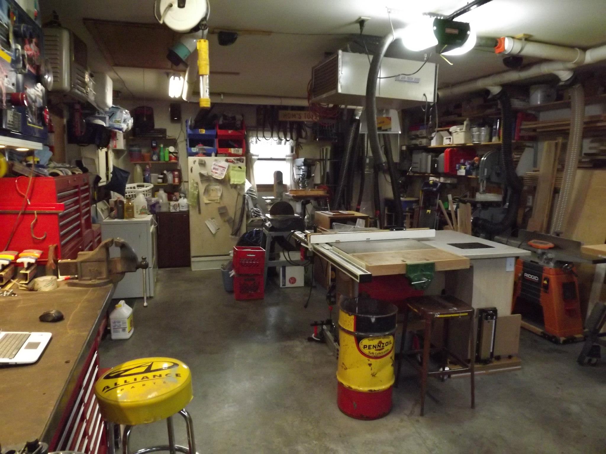

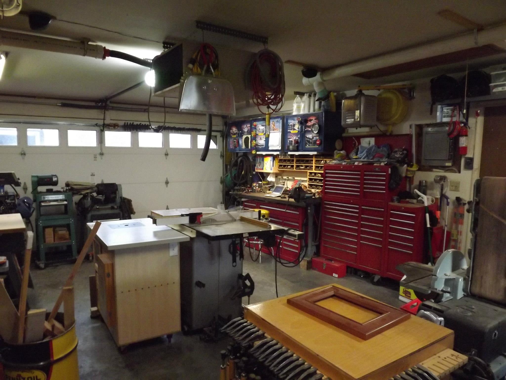

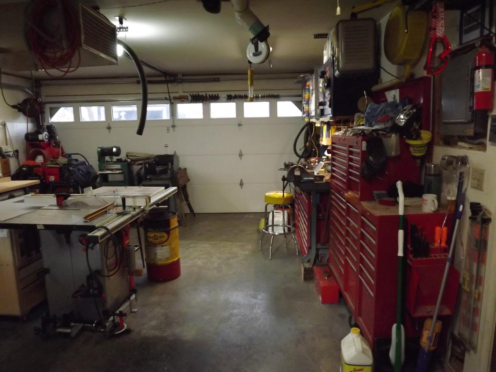

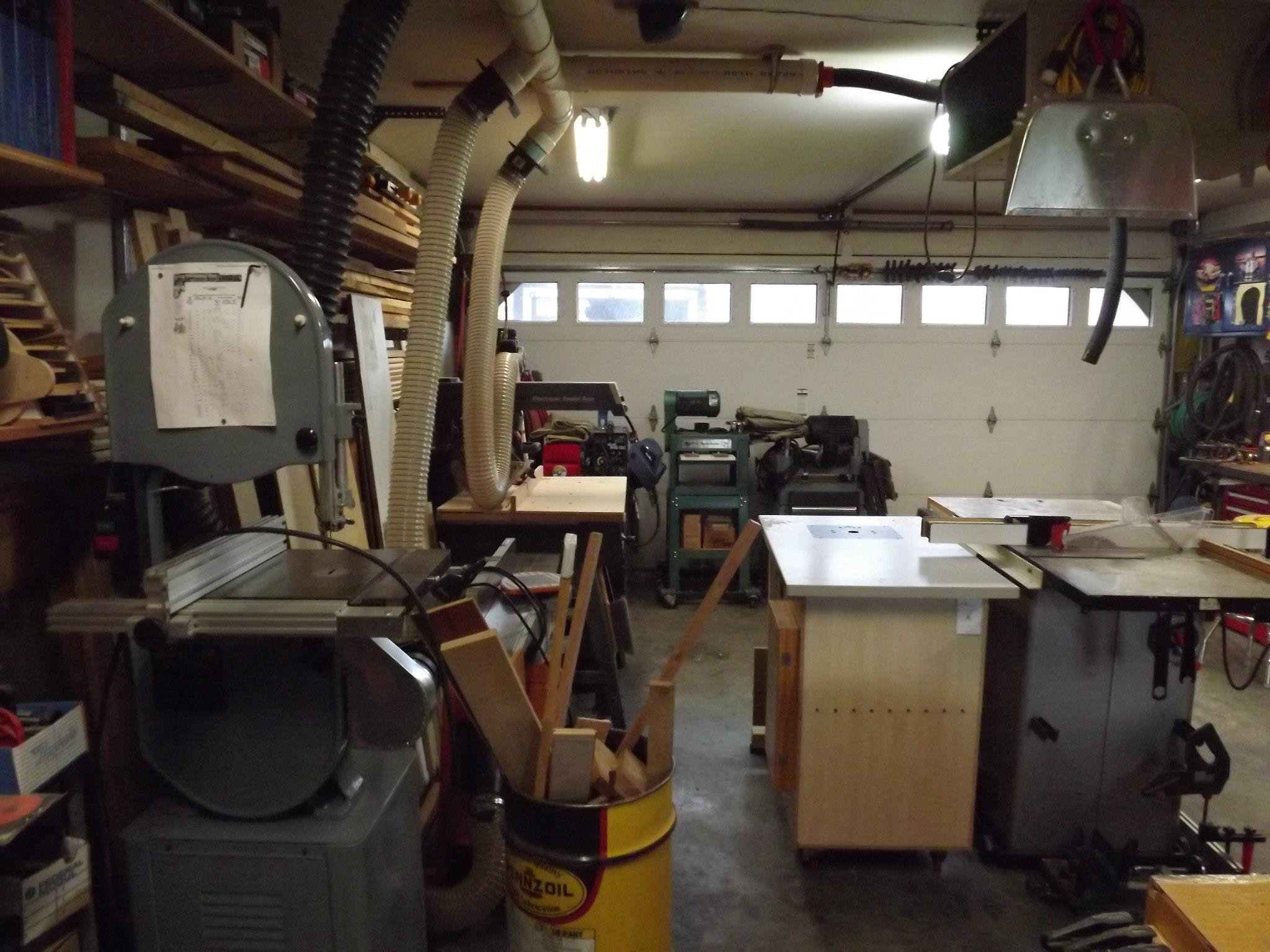

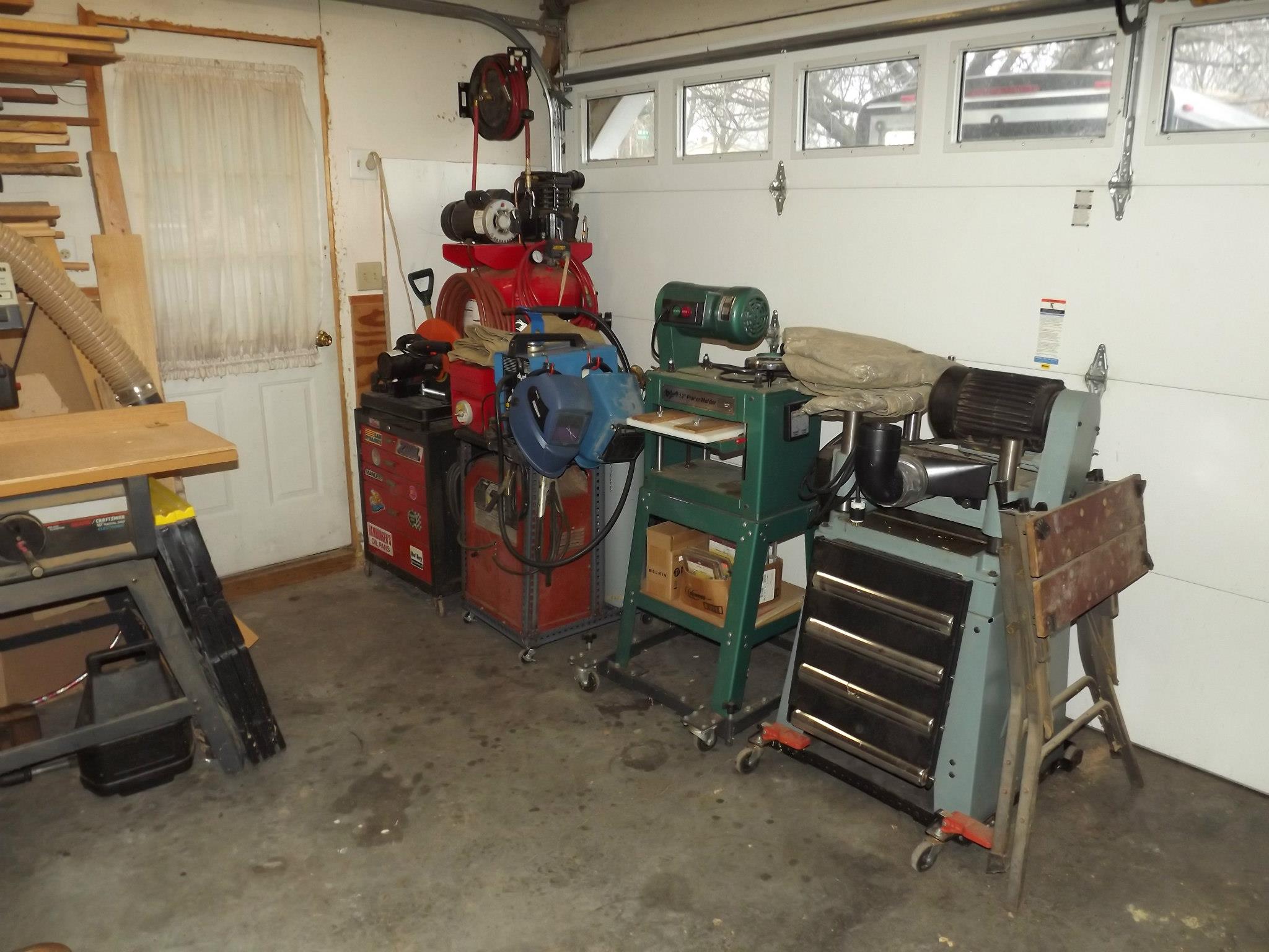

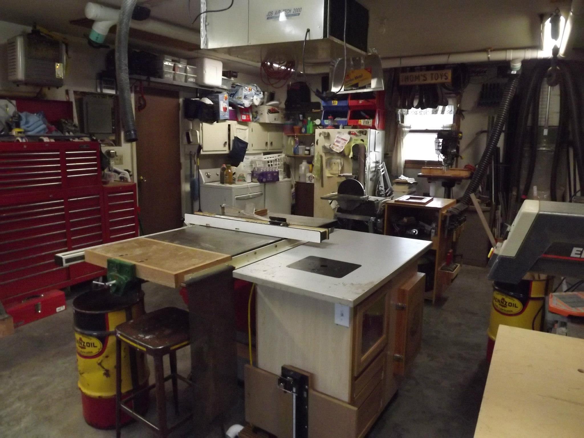

    Figured I'd share some photos of the shop as well. (While it's still suitable for photographing )
      Good to hear from you Thom!
      The shop looks good, especially the overhead cabinet doors! It's too clean. You have either been taking lessons from Rod, or you need a little sawdust time...

            Oh that is very cool. Glad to hear from you and see you are keeping the faith. I too like the finish on those cabinet doors.

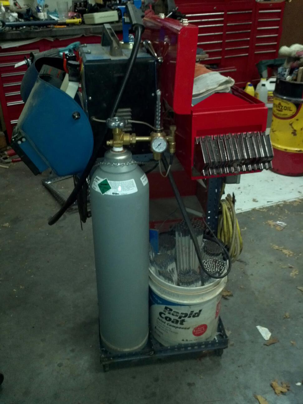

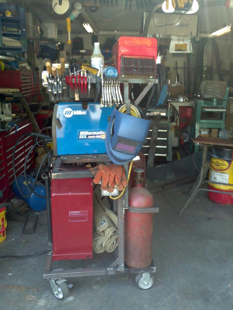

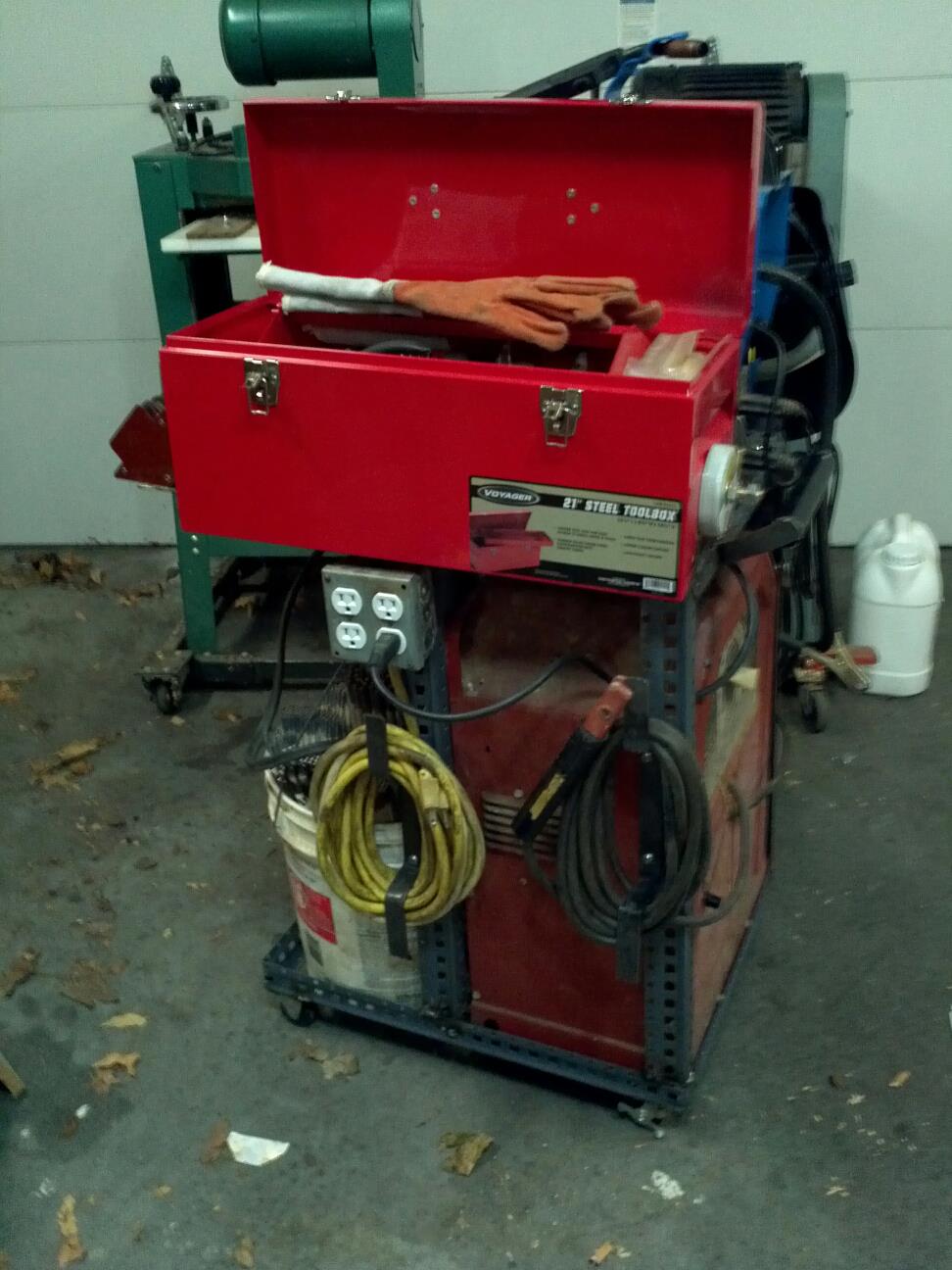

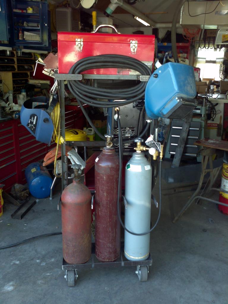

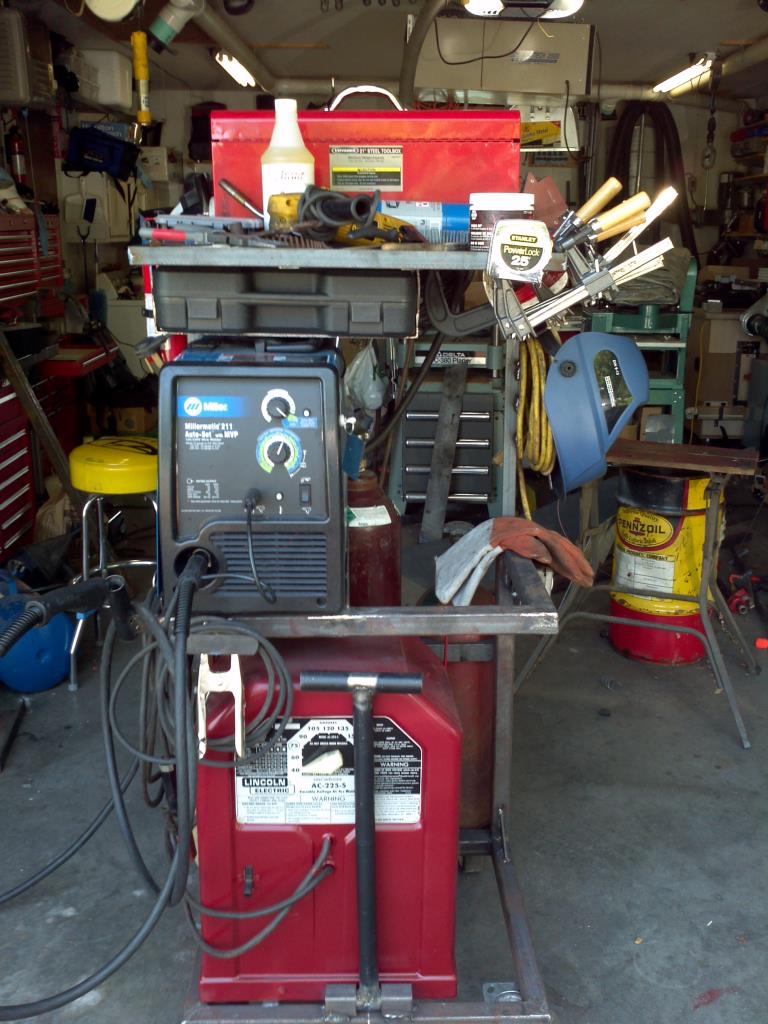

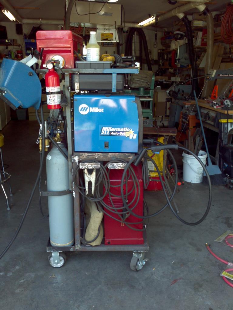

              "I'm just going to build a simple welding cart" --- said someone who totally underestimated how overly complex he can make things
              My wife finally made me admit that I have a 'problem'

                I don't know how Rod does it, Pappy ..... I feel like I spend more time cleaning than I do working in the ****** thing!!!!
                  Other then the missing tank chains, that seems like a simple welding cart (keep your needs handy). I don't see a problem.
                    • 3791
                    Thom2, is that a Dillon torch set in your welding cart?
                    I tried the welding cart route in my past and after I bogged it down in the yard we decided that was the reason you see all the welding equipment mounted on a 2 ton truck, and I could never remember needing stick, wire feed, tig and oxy/ac at the same time, so I went to individual carts for each.
                      Still far from 'done' ... retainer for the tanks is at the top of my list. I'm also waiting on a piece of 1/4" to 3/8" plate from a buddy of mine that will be installed to the right of the mig to make a small flat tack table for quickie projects. I still also need to finish the bottom tray and install some sort of stick rod holders (I have about 100lb of stick electrodes). Miscellaneous holders to be installed including helmet holders, nozzle dip holder, tank cap storage etc.
                      Then after construction is all done I'll tear it all down and clean up all the welds, blast it and paint it.
                      I do have a question tho' .... I've kinda set this rig up that both welders ground to the entire rig and then was planning on using another single lead with a magnetic ground, neither welder would never be plugged in at the same time but my Dad did express some concern about the tanks being grounded to the chassis. While they are inert gasses and pose no risk of explosion from the actual gas, he's raised a concern in my mind about insulating the tanks from the chassis as a safety issue. I'm curious of opinions on whether it's a fully warranted concern???
                        capncarl
                        The ocy/act set is a Harris torch set.
                        I fully agree about never needing stick, mig, etc all at the same time. I opted to keep the ocy/act rig totally separate as it can be used for junk yard runs, field work etc with no electrical requirements. Ialso didn't like the idea of an acetylene tank being onboard with electric welders. To be honest, to some degree, acetylene scares the living crap out of me.
                        I've had a 110v mig for years that has got me out of a lot of jams and fixed a lot of stuff around here. While I did want to upgrade, I was afraid to be put in a position of "NEEDING" 220v for a bigger mig. That fact kinda put me off of the upgrade path as I still wanted the 110v mig for portability and field work. When I found the Millermatic 211 w/spool gun on an AWESOME deal I just couldn't pass it up as it is dual voltage and a simple change of a quick connect plug takes it from 110 to 220 which fits my portability requirements as well as giving me a VERY capable welder that will also handle aluminum (been wanting to do aluminum for YEARS). In the shop when I have 220 available this welder kicks some pretty serious ass.
                        I built the entire mig/stick cart around the fact that the mig is still easily removable for field work, actually both units are easily removable for individual use but stick requires 220v 50amp and I don't see that ever making it out of the shop area.
                        All in all, I've put quite a bit of thought, consideration and planning into all of this and I'm quite pleased with the way it has all come together.

                              My brain has been back and forth on the insulated tank issue. I think I can see his point though, that if for some reason the ground became live, you wouldn't find it out when you went to shut off the tank.
