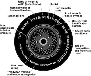

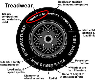

                A few hints that might help. All tires have a treadwear rating, it's right on the tire. The lower the number (actually starts at zero) the softer the compound (wears faster, but rides better and has more traction). The higher the number the harder the compound (could be 200-400). There's quite a bit of info on the side of tires. In addition, you can tell when the tire was manufactured. This might be of some help...
