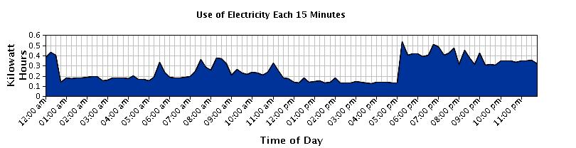

    Anyway I decided to look at it. Here's my electrical usage one recent Tuesday. I can see when i get up at 5:20 AM... and when I come home at 5:15 PM and we turn on the lights, TV, and fire up the stove... No A/C yet. Looks like my wife quite watching TV and went to bed about 12:30AM the night before. ANd I'm betting she got up at 7:30AM.
    What are you guys doing with your data, if anything, or what can you do... any free apps out there?
    Stupid web page can save the 15-minute interval data for any day I choose... except it uses the same file name every time.

      That does look like useful data. I would enjoys being able to figure out, like you did, what went on, or off, at what time and who came in or left at what time.
