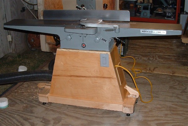

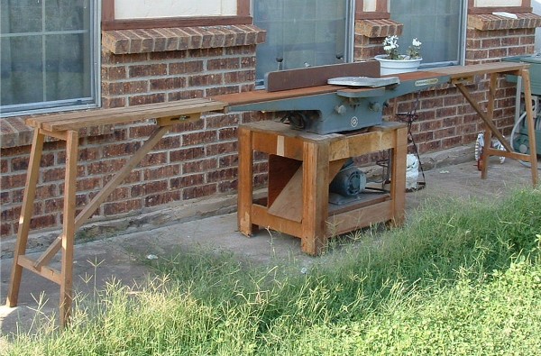

                        Got lucky when I found mine for $165 at auction. About $20 for new head bearings, $10 for the belt, $15 for paint, and $50 for casters. The stand was bulit from stuff I had around the shop. About $260 total invested and a LOT of labor to break it down, run everything through electrolysis, repaint and reasemble. The only things the knives needed was cleaning and a few swipes with a diamond hone.
Name:	With Table Extensions.jpg
Name:	Up and Running.jpg
                        The extension tables got recycled as cutting boards for Christmas presents.
