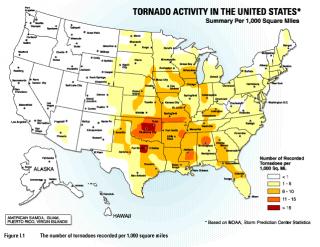

              I can certainly understand her fear, especxially this year, but you might want to show her this. I pulled up a lot of maps to assuage LOML's fear re: not just tornadoes, but earthquakes too. Never say never, but the odds in your area are very low.
