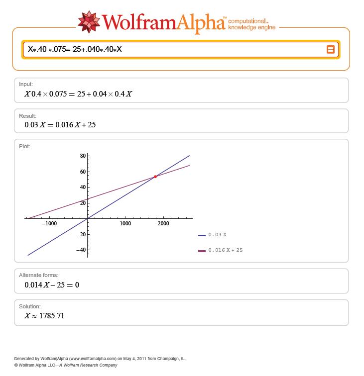

    FWIW, I just calculated the specific payback numbers (at $0.40/kWh):
    "40W" LEDs @ $25 ea & 50k hr life:
    • 930 hrs (~6 mos) vs. 75W incandescents
    • 10,000 hrs (~5 yrs) vs. 14W CFLs
    "60W" LEDs @ $40 ea & 25k hr life:
    • 1,500 hrs (~9 mos) vs. 75W incandescents
    • 50,000 hrs (= never) vs. 14W CFLs
    Hopefully my math is correct, but I presume Loring will check.

                          since you ask, I get 1786 hrs instead of 930 hours.
                          I assumed incandescant bulbs are free, LED bulb is $25
                          Inc uses 75W, LED uses 40W
                          50KHr life is irrelavant
                          electricity is 0.40/KWH
                          you didn't say how much your CFLs cost so I could not check the 10,000 hour number
                          you didn't say how many hours per day you presume to use the light so I can't check your conversion to days, even if your hours were right.
                          the attached Wolfram Alpha calculatioins shows plot of $ (vert) vs time (Horizontal X-axis). The LED line thru $25, 0 shows the initial cost of $25 and lower usage rate, the Incandescant line thru $0,0 shows no initial cost but faster consumption of electricity per time. They cross at 1786 so after 1786 operating hours the LED is cheaper.
                            Very fancy!! But the discrepancy is that the LED uses 8W (not 40W).
                            The "40W" LED is similar light output as a 40W incandescent (~400 lumens), but only draws 8W (the "60W" LED bulbs put out ~800 lumens, but draw 12W).
                            I calculate it old-school:
                            Savings (75W-8W) = 67W
                            Savings in kW = 0.067kW
                            Marginal electricity rate/hr = $0.40
                            => Savings/hr = 0.067*0.40 = 0.0268
                            Net LED bulb cost (assuming incandescent is $0) = $25
                            => Hrs to break-even = 25/0.0268 = 932
                            I assume that 1 year = ~2,000 hours, but YMMV.
