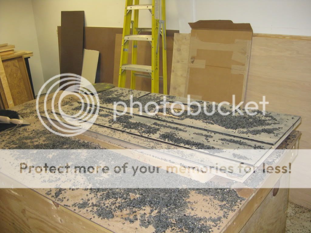

    Here is the current project I am working on. Who knows what it is?
    http://i400.photobucket.com/albums/p...w/IMG_0400.jpg
    (If you guess a mess, I already know that)

    Nice looking router table top.

      Umm.... asbestos?
      Looks great -- plenty of room!
        A jig for routing asphalt slabs?
          Fixing a hole in the roof?
            • 9542
            I'll second the hole in the roof. That looks like the gravel stuff from shingles all over the watever it is...
              Sure reminds me of mine except you have two miter slots and you are using a fine looking top.

                Looks like trex deck shavings
                Looks like you are routing the edges on a composite matereail like trex.
                Link
                  Is that phenolic?
                  I abhor working with that stuff. Our lab benches are made of it. It was a
                  bear to have facilities drill holes in it for a monitor mount and monitor cables.
                  That guy definitely needed a new hole saw after that.

                    Gary was right... it is the top to a router table I have been planning to make for a long time.
                    The router table top is currently 49 1/4 x 24 1/4 and I need to cut it down to 48x24 to finish it up. I picked up a 1/2 sheet of 1/4" black HDPE to use for the top. The top was made of 3 layers, a MDF base, pegboard middle and the HDPE on top. My router lift was thicker than the 1/4" HPDE and I didn't want to take anything off of the MDF since the lift and router is a heavy load. So I stuck a layer of pegboard in the middle to make up the difference. Polyeurathane glued all 3 layers together and clamped it to death. I decided on the pegboard instead of a sheet of hardboard since the glue had space to expand in the holes.
                    I decided on 2 t-tracks for the slots so I can easily use feather boards/etc with almost any width board. I could make a sled that utilizes both tracks in the future.
                    As far as the mess the HDPE made, the picture is only the millings from the final slot I cut. I had atleast 4 times that in total debris.
                      • 9542
                      That is a router table top?
                      Do you need FAA clearance to get stock to approach the flight deck there?
                      I don't mean to say that's big but daaaaaaannnnnnggggggg!
                        Pretty clever.
                          Originally posted by dbhost
                          ...Do you need FAA clearance to get stock to approach the flight deck there?...
                          I was also looking for the catapult and arresting cable.
