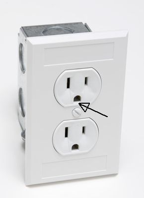

                Every outlet it my house is ground side up (except the ones I have replaced).
                (In addition, all the light switches are 6" too high... drives me crazy)
                I had to replace many (most) of the outlets as the little piece strip of plastic between the "top" of the ground and the edge of the outlet was broken.
                I think that the natural tendency when unplugging something is to pull out and up at the same time. If the hot/neutral us up, there is more plastic there to bare the strain.

                  Interesting... I'm also in the "ground down, just because it looks right" camp, though some of the reasoning behind ground-up seems awfully sound (new info to me!).
                  Interestingly, DaveS, I just moved around (and promptly replaced) a couple outlets in my basement shop for exactly the same reason. They had been ceiling mounted, so plugs were typically plugged into / pulled out of them straight, with less likelihood of being pulled out at an angle. Yet still the plastic directly "under" the ground lug was broken on each of them.
