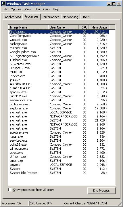

    i use firefox for internet. at times, the CPU usage goes to 100% and stays at that speed until i close firefox and then on restart everything is fine. in the task manager, it shows that firefox is using the CPU at 100% or 99%. during this time, there is a split second when it comes down to 0%, but the temp nor the speed of the fan show it, all you see is a small spike in the task manager.

      here the computer specs:
      AMD 64 3400+
      1.81 ghz, 640MB RAM
      there are usually about 36 processes running. when this happened, the firefox mem usage was like 386,000k.
      here is a shot of my task manager list looks like:
      omar
      • footprintsinconc
        • 1759
        • Roseville (Sacramento), CA
        ooops, here is the pic:
          AMD 64 3400+
          1.81 ghz, 640MB RAM
          There is your problem. Ram is cheap, but, the age of the motherboard is against you and prices for older ram is rising. You should upgrade to as much as you can or 4Gig. Fry on line has had some nice sales with rebates. If you visit Crucal.com and run the scan it will tell you how much and what type to get.
            you need RAM seriously bad. memory is swapping continuously i suspect.
            Unload some of those (unneeded) processes you have running.
            If you have video shared memory that's a load, too.
            I don't think any of the current crop of browsers will run with less than a gig of memory. Use an old browser an it will freeze on the current day content.

                  Is your OS XP or Vista Min for XP is 640 K MIN for Vista is 1 MEG Vista will show 100% Mem usage no matter how much Mem you have in, but with Vista you can use a USB thumb drive for ram to see if that is the problem.
                  If you have any high end graphic programs running 640 just isn't enough even with XP. My autocad would just really slow up (high cpu usage) until put in 2 gig of ram.

                      i have xp home, dont know what service pack because i am at work right now. it is firefox 3 that i have. i dont have this problem.
                      interesting, so it is the memory. it only has two slots, so how do i know what memory to order? i think it sticker on it says ddr2, but how do i know how many pins? the stick also has a couple of notches, so without seeing the memory, how do i know it will fit?
