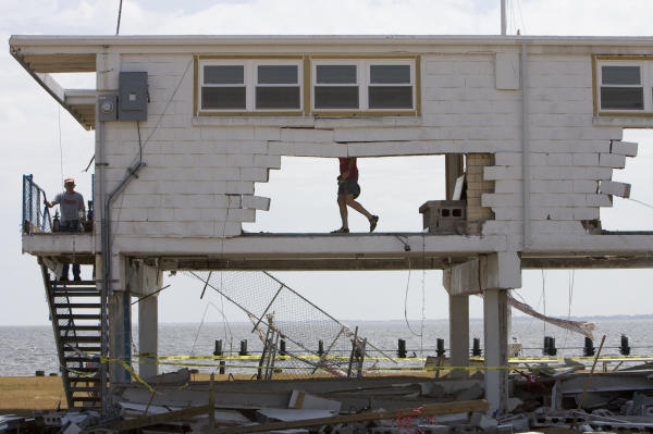

    It's still hard to imagine what a hurricane can do. How big is a 17 foot storm surge?
    this beach house is in seabrook, tx, 20 miles North of Galveston, on the shores of Galvestion bay. You can see the height of the storm surge damage.
    I'm somewhat amazed the stairs are still there.

    Probably less resistance to the water, since the stairs are open. Wow. What a mess.

      I woudn't want to be standing on those stairs unless they are cantilevered. From the pic it looks like they are.
        Looks like a piece of the top guard got taken out. Or it might have been to a wrap around deck. The placement of the electrical box & meter seems unusual. Doesn't seem to be much reinforcement in the CMU walls though.
        I wonder if there were block walls under the slab? In a house we did in FL I had to do a bunch of calculations for flow-thru openings and do some other break-away walls. A lot of the ground level walls were designed to fall away if a storm surge hit them. Still had to do a certain amount of openings for water flow though. The stair design was challenging too.

            Wait a minute, something else I just noticed.... are those concrete block walls? It sure looks like they are.

                  And yeah, that was a concrete block wall...
