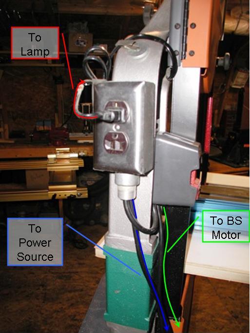

      2) wire the lamp before the switch so theres only one plug but they operate independently.

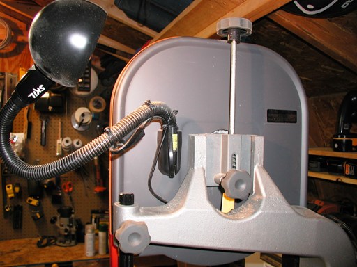

      IMHO, that is the way to go; that's what I did on my BS. Actually, I wired in a receptacle box before the switch so that I still have one spare receptacle. The overhead lamp just plugs in and runs independently from the BS. That way you can use the light to setup jigs, fences, etc. without having to have the BS on.
      And there's a spare power point if I never need to add another accessory. Total cost $0 (all spare parts lying around or salvaged from other dead items).

        Can anyone sketch a diagram so I have something to follow? Thanks

          Here's a couple of pictures. By sketch, did you mean wiring diagram, or location of outlet box? The gooseneck lamp I got lucky and picked up two for $7 each at Lowes many moons ago when they were being cleared out. The two pictures show the location of the lamp and the outlet box.
          Sorry the pictures are so bad. These were a couple I had on the hard drive. Can't take any more right now, as my tools are in storage until we get settled in here. I miss my tools!
