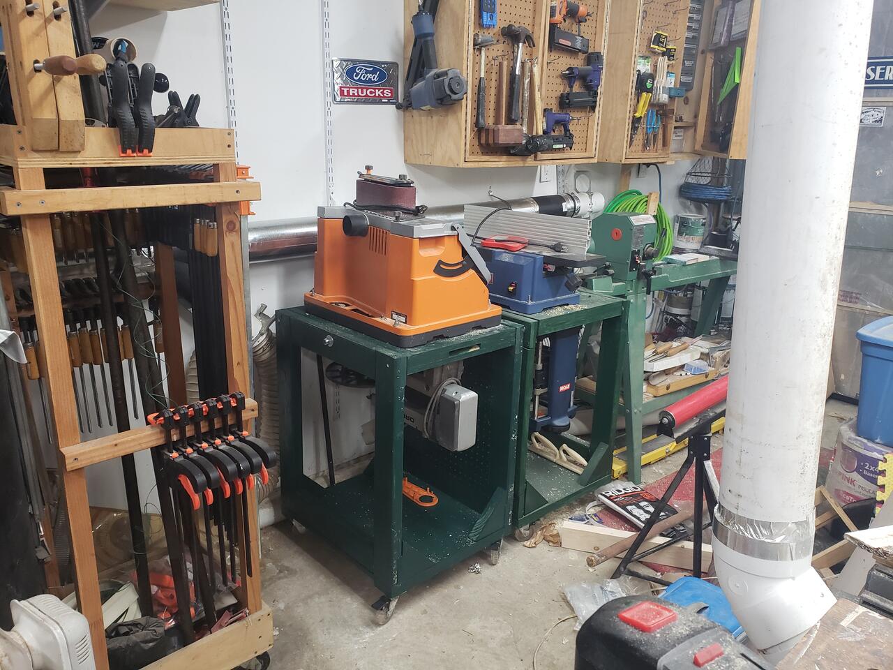

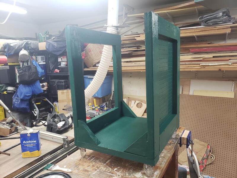

    This is flip top stand #2, in paint. The sandwich is ready to go and already dried paint. All that is left is to let the paint dry, assembly of the axle through the frame and sandiwich, measure and drill for the stops, and lastly install the tools, assuming I can locate the basket. If not I need to go to Home Depot for another pegboard basket as it is more or less key to the design.
    And with this done, I am out of my Harbor Freight 3" urethane casters. A pity too, I rather like them
    This one seems to have come together much nicer than the first, although through the online pics it might be hard to tell.
    For what it's worth. I have about 7/8 of a gallon of paint left, obviously it is going to get some more use in the shop. Half tempted to paint the miter saw cabinet drawer fronts with it. Will DEFINATELY paint the lathe ballast box and storage cabinet with this stuff.
    Oh and the white melamine on the pegboard does NOT like to be painted. I supect the paint will just fall off of it over time.

    Well crud. It would appear the all thread I got for the axle is 5/8 not 1/2". Need to head out to Home Depot tomorrow for the remaining item.
      Done, except the basket...
      I am not quite ready to flip side to side.
      However, it looks like the Behr color match isn't quite a match. Oh well, clsoe enough...
      Lessons learned?
      #1. No matter how much you think it will speed up things, resist the urge to cut half laps on the band saw. You will NOT be happy with the results.
      #2. The factory made cans of Rustoleum hunter green are NOT the same color as the digital color matched Behr hunter green. Not a huge issue. the Specific shade isn't critical just a little annoying is all...
      #3. Just when you think you know where you put something, A.K.A. the pegboard baskets, they grow legs and walk off on you...
      #4. The Harbor Freight 3" polyurethane casters are honestly REALLY nice for light / medium duty shop projects. Much better than the whatever brand I bought at Home Depot for hte clamp rack.
      #5. My favorite part of this whole project has got to be cutting the rabbet for the peg board, and squaring the rabbet up.
      #6. I used scraps big enough to hold the bushing pipe in place, AND provide support for the fasteners, but I did NOT include a full block of wood in the middle. This allowed me to save material using scraps, and save weight, although a negligible amount.
