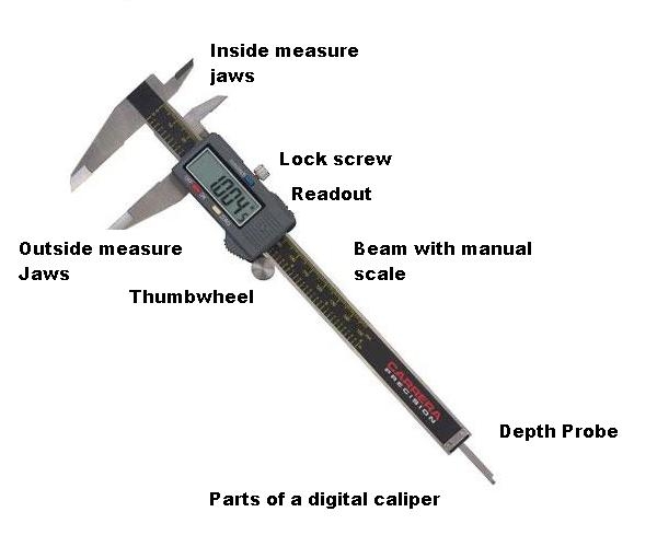

    Familiarize yourself with the parts of a caliper:
