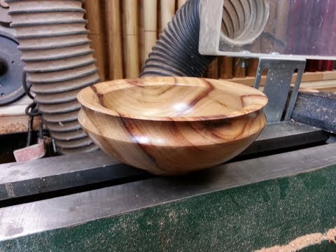

I recently got some camphor logs with nice color inside, and decided to make a small bowl/candy dish. I ended up going through the bottom (depth gauge issue) and decided to try to save the piece because of the interesting grain and color. Video linked below. Thanks for watching!

Hey Bill,
Beautiful bowl and great video. I have a question. How did you fill in the tear-out near the upper edge. You said you used padauk chips and Super Glue. I'm not sure I understand how you pulled that off. Do you grind the chips down and mix with glue or ..... I don't understand. Thanks.
RichardRichard -
Hi Richard, just now seeing your response. Thank you, I love camphor, and hope to turn some more soon. Yes, the padauk is essentially shavings from the lathe (other turnings), and when I use these or similar to fill cracks or knot-holes, I crush them into a more powder-like consistency, push into the target area, and add thin CA - this soaks into the material and sets/cures very fast. I repeat until there's enough material to leave the fill slightly proud of the adjacent area, then I resume turning. Coffee grounds are another great "natural" filler.Last edited by Bill in Buena Park; 09-13-2017, 05:06 PM.Bill in Buena ParkComment
You think it came out ok??? It came out great! You made it look so easy ( and I know it's not easy)
The bowl is lovely and the center save is awesome. You make me want to be a turner.

Hi Joann, thanks for your kind comments. I think your idea is creative, and might work with one of those plastic flower pots that has the little drip tray underneath. I'll see if I can find one, and see what I can come up with.
