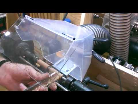

I hadn't the time recently to make any pens, so decided to do a PSI Trimline with some Zebrano (Zebra wood), and used the little NEJE laser to engrave it. Link below to the video of my process (alert: somewhat long, but I've some added music to ease the pain...) Thanks for watching!
Pen turning - PSI Trimline in Zebra wood
My process for turning a pen, using Zebrano (Zebra wood) and a PSI Trimline kit. I use a little laser engraver to add engrave a name on this gift.Bill in Buena ParkTags: None -
