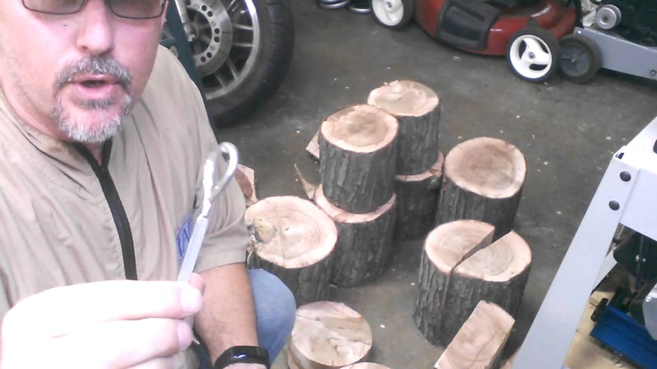

    Just a quick video on how I turn logs into bowl blanks. Thanks for watching!
