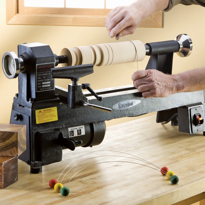

          While I'm seeing the two links to Michael's, I'm not seeing a picture of you "wire burn"... did you post one? I'm not a woodturner, but I would like to see an example of what you are talking about.

            I didn't have photos in the OP, but here are a few - one of my small burning wire, one of a recent tool handle I made with the lines burned, and a picture (not me) from KC-brand wire burners, showing how I use them.

              Thanks for the picture post. Not being very familiar with turning, the "wire burning" left me curious. That's pretty neat (as we used to say), and makes for a very nice 'look' on a handle or other turned project.
