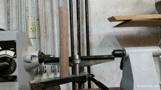

      I have 2 live centers. I think they are both the cup/point type, right? You can see both in this picture.
        Drilling on the lathe would require a drill chuck for your lathe, but not necessarily a scrolling chuck to hold the workpiece (although I find this is the best practice). Don't know if you have a Harbor Freight nearby, but they have an MT2 drill chuck that would work (its the one I own and use.) If you go this route, without a scrolling chuck, I have seen a spur drive used in the tailstock with the drill chuck in the headstock - you would have to hold your handle blank securely as you start to drill and advance the tailstock; after about an inch of hole started, you could manually push the blank further onto the drill bit, still holding it securely, and remember to back it off a bit to clear chips. If you question your ability to hold the blank securely, this may not be for you.
        Looks like your live centers are the cup/point type. In this case, if you aren't interested in buying a 60 degree cone-type live center, you can make one to fit over what you've got. Here's a YouTube link on something you could make from some shop scrap.

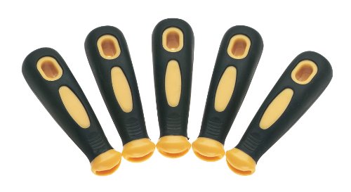

          You know they sell these darn things for 1-3 bucks a pop. Hardly worth getting your chuck dirty.
          Is this what you want? The tapered tail on most files threads into the steel threads on these handles.
          Lowes and home depot have these as well.
          http://www.amazon.com/s/ref=nb_sb_no...ds=file+handle
