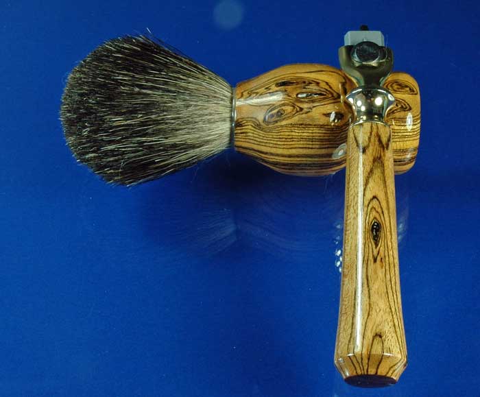

    The razor and brush are done from a stick of Bocote that I have had for several years. Sanded to 400, 8 coats of CA/BLO and finished on the Beale wheels. I didn't drill the hole in the brush handle quite deep enough, maybe I'll remember to do a dry fit next time.

    Those look great. Nice job. Good luck with your surgery
      Beautiful grain and finish Dick. Wishing you a speedy recovery on your surgery.

        As always, Dick, they're beautiful.

          Good luck with the surgery. Now if only that razor was a safety razor style......
          (my non electric, as I don't think you have turned one for an electric razor yet )
            That sure is nice... Good luck with the surgery!
