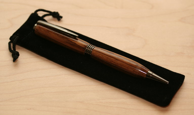

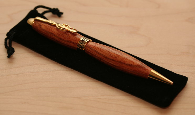

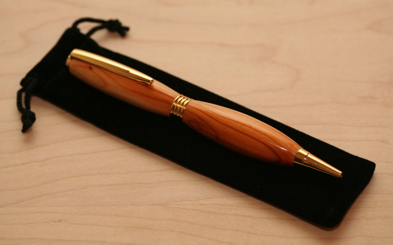

    Here are a few more pens I did over the weekend. I'm a little unsure of the wood species, so I'd appreciate any input from the pros out there! I got a box of blanks from woodturnerscatalog.com that included Padauk, Zebrawood, Rapala Lacewood, Marblewood, Holly, Bloodwood, Yew, and Canarywood. Some of these are a lot more obvious than others! (The last one has a a couple coats of tung oil, followed by 3 coats of CA, then Hut PPP. The others just have the CA and PPP.)

    Kit: Apprentice Roadster, Gold
    Kit: Artisan European, Black Titanium
    Kit: Artisan European, Gold
    Kit: Apprentice Roadster, Gun Metal

    The top one looks like the canarywood;
    Second one: I want to say Yew but could be a light padauk.
    Third one: Marblewood
    The bottom one does look like the zebrawood to me.

      Sorry, Hank -- I could have been clearer, and I'll go back and fix it. What I meant by "natural" was that there was nothing on the other pens that might change their color. On the first three I used three coats of CA and Hut PPP wax/polish. On the last one I did the same, but after a few coats of tung oil, which darkened the wood a bit.
      I was thinking padauk for the second one, and actually I couldn't decide between canarywood and yew for the first -- I haven't worked with either before and from the photos online they both looked similar. I have marblewood and zebrawood for numbers 3 and 4, too, so that's a good sign. Thanks!
